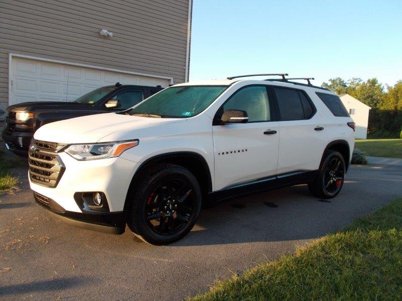

Use the Silverado now only for heavy work.....the '18 Traverse amazes the crap out of me, a whole different model compared to my '15. All the high tech goodies with on the fly 2WD/AWD 310 hp V6 that 0-60 in 6 sec and gets 29-30 mpg (yes, 30 mpg ) on the highway in 8th and 9th overdrive ears, mill is turning 1800 rpm at 70 mph and drops multiple gears so it still has plenty of steam at highways speeds. Four comfortable buckets plus a three seat bench for Moe Larry and Curly. Handles like a cat and climbs hills like a goat, new high performance torque convertor and improved low gear clutches in the tranny. Acoustic glass and active noise cancellation for a quiet ride. Equipped with radar, front, rear and side HD cameras (even has a camera washer for the rear)and 8" screen with night vision it synthesizes a top down view of the vehicle and surroundings....electronic wide angle rearview mirror so no heads blocking the rear window..you can black out all the windows and still drive the car! D optic LED headlights with no more shutters so both high and low beams operate simultaneously on high. Pedestrian alert and auto braking can spot a deer at dusk and give me half a chance of avoiding collision with those road rats. There's even a gremlin hiding in the Nav head that auto zooms the map and duplicates turning directions in the 4" speedo display as you approach as turn/turnoff. New multi link rear suspension squats on a hard stop so no nose diving or pitching in turns. Damn thing is more fun to drive than my old Camaro, a sports car when I'm in and a family car when the wife is riding shotgun without being a cop magnet! It is physically larger than the Tahoe and downsized GMC Acadia and goes for $15K less than an equivalent Tahoe. Took Chevy 10 years to redesign the Traverse and though the new ones bear the nameplate it is a completely different animal, only parts in common with the gen1 are the lug nuts. Looks good in the Redline blackout version with all around LEDs. Sorry to go on about this but I'm amazed every time I get into it.......this is the finest driving Chevy I have driven in 50 years of driving.....even better than my '74 Impala Custom 454 that got 6 mpg.!
Anyone in the market for a Tahoe or Suburban should take a look at the 2nd gen Traverse first.
I will agree with everything you have said about the 2018 Traverse. We bought ours in April after the Dodge dealer told us that our 2015 Dodge Grand Caravan which we bought new with less than 10 miles back then and at 40k miles earlier this year needed its trans lines replaced. We searched around as my wife was ready for an SUV and to get away from a van.
It lead us to the Traverse. This Traverse rides so smooth and the 9 speed trans makes me so jealous when riding my 6 speed 2018 Silverado. I only test drove a previous gen Traverse, but this new one should win GM some awards for innovation in this class. We have an LT trim with four bucket and a rear bench, even with cloth these are some very comfortable seats.
Some of the features in the Traverse make me wish my Silverado had these too, guess it’ll be for the next truck whenever that comes in a few years. I agree if anyone is looking for a family SUV the 2018 Traverse is awesome.
