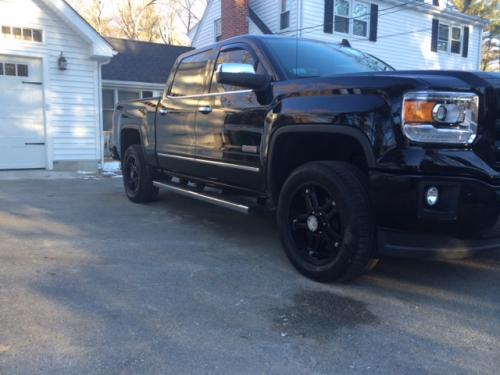

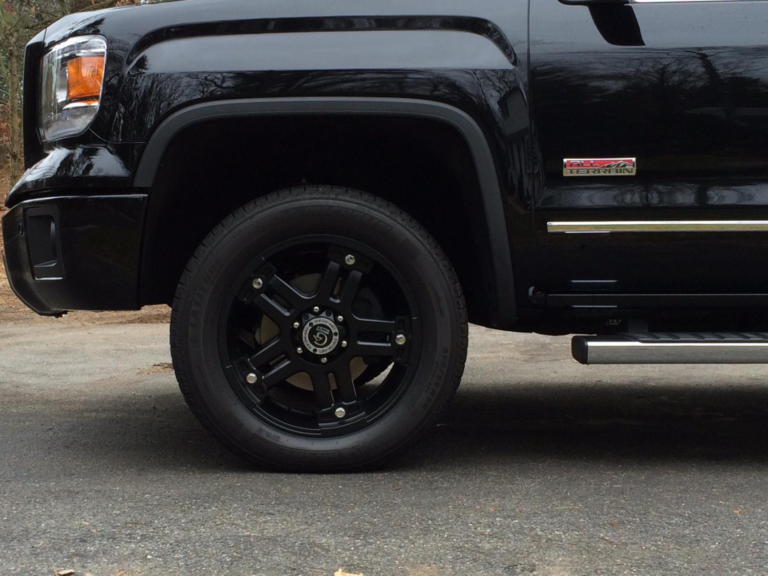

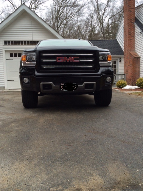

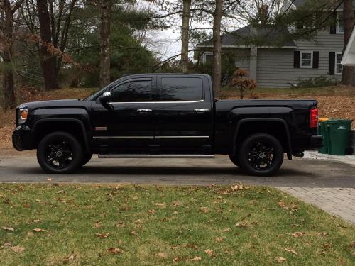

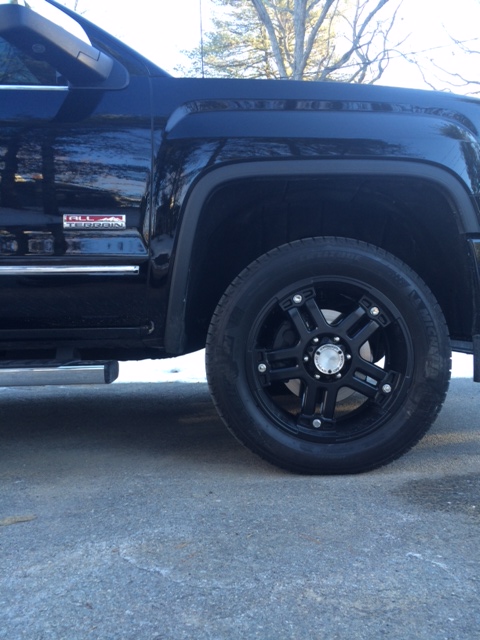

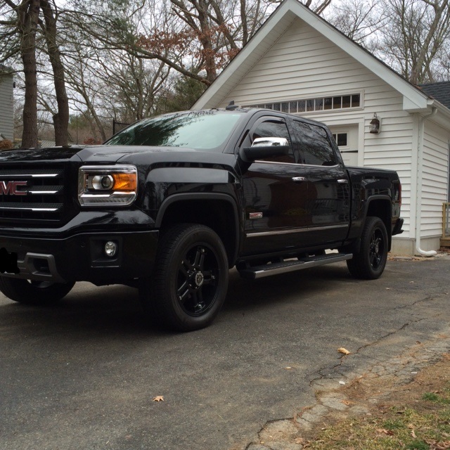

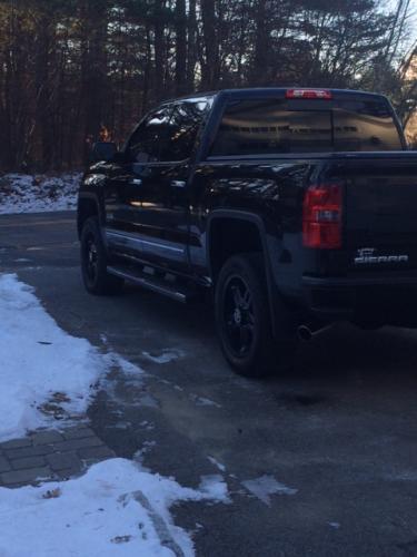

See attached pics from this morning, light was a bit dim, but you can clearly tell the difference from stock stance. Unfortunately was too dark when I dropped it off for the install I forgot to take a good "before" shot, I may be able to find a decent one someplace. I definitely will remove the lower valence - I think it will complete the look, and I'm going to have the shop flip the rears so their in the correct position, although to be honest I noticed nothing weird in the ride - its just way better than stock!!
I would like opinions for when I add 286/65/20 BFG KO2's - and they will be the primary tire 9 months of the year - would you mount them on the black granite alloy wheels in these pics or the stock All terrain 20"s? ON the one hand the stock AT rims are "nicer" in terms of finish & quality I think, and IMO are one of the best looking wheels GM has ever made. On the other hand I'm fairly certain the granite alloy wheels are a good amount lighter than the stock AT's - I always notice the winter tire setup is easier to move around though I've never weighed them. It would be nice to offset some of the weight gain from the beefier BFG's by mounting them on a lighter wheel - on the other hand I still like the look of the stock AT's, they have a better finish/clear coat, and are by default more valuable so the option of taking them off in the winter is nice too.
EDIT - forgot to mention, my measured height difference from top of front tire to bottom of wheel well/fender liner in front was a hair over 2" - like 2.1...so I dunno if there is "settling" that will occur, or if the shop inflated my tires more but it was def more than the 1.87" advertised. Not going to complain on that one.

Truck looks great. I just picked up a 15 Sierra and realized they went away from torsion bars. Out of the loop I guess.
