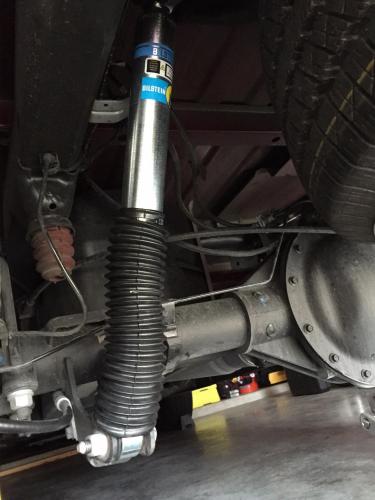

Installed the rear 5100's today. Short test ride afterward. Smoothed out some bumps noticibly. This is while it was still on the jacks. Can't wait to install fronts now.
