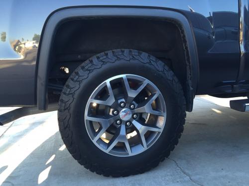

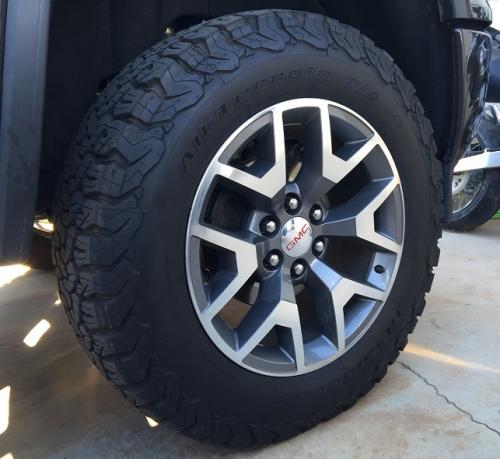

Here's the pics of my truck (2015 All Terrain) I have the 285/65/20 with a 2.5" level in the front only. There is only a slight rub in the front when i lock the tires while turning. I have taken it on gravel, mud, and packed dirt and haven't had any issues with the tires being too large. I love them, been over three months so far, they have been awesome.
Here is where the tire rubs on the inside of the well. Not sure if it is because the All Terrain's come with that carpet crap. It would be easy enough to cut out, and the piece it is rubbing on actually is sagging forward a little bit and at an angle heading towards the tire. Not sure if you can see it that well in the picture.
  • Like 5
Here is the front and rear tires, sorry if they are at a crappy angle.
Forgot to mention, these are on the stock 20x9 all terrain wheels that come on the SLT Plus package or whatever.

how big are your tires on your truck what are your tire measurements. From ground to top of tire looks awesome btw
