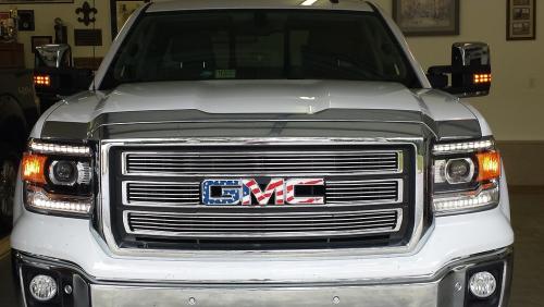

Finished my install today. I tried unsuccessfully to find a better place to tap amber and white led's but gave up and went to the fuse panels as others have. My ambers are tied to park lights in the under hood fuse box and the white led's. I went to the cargo light in the passenger side fuse box. One thing interesting is that once I hooked up the driver side amber the passenger side worked with it. The white LED's are coming on upon remote unlock as puddle lights and when I activate the cargo light switch. I did some testing to reverse lighting and was unable to make the reverse work when the truck was running and in reverse. There was some strange intermittent things when running and in reverse so I stayed with the cargo lights. I did have the white led's on when the mirrors were folded in and they were bright in the cab and I was in a lighted garage. Those led's are bright, anxious to see them tonight. Overall I am happy with the mirrors, great view, look great, and power folding!

That's looks great! Going to add those pics to the first post. [emoji106]
