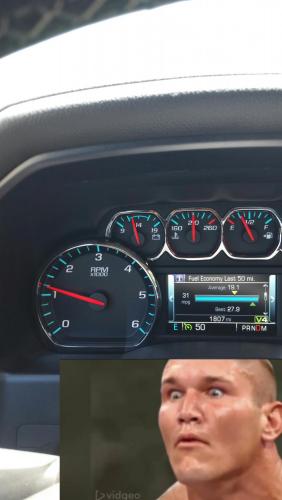

I haven't seen a pic.. and thought I would post.. here you go when I first noticed i said oh wow that's nice..lmao bit looked online and seen that it's normal. And yes that was my reaction at first
