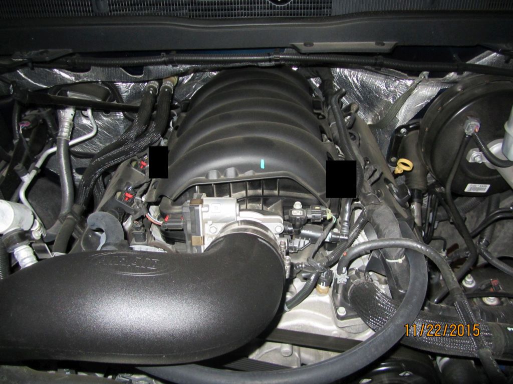

FYI, If anyone has a 2015 and the 2 front studs are not there for using the cover, the GM part number for these studs are #16616691. You need 2. List for 4.10 each.
Anyone got a pic of the studs used for mounting this cover? Looks like a mod that I just have to do...
Took another look with a light and think I found them. I cut out the area of the pic where I think the studs are... (I can't find the software to use to mark in a photo that some use).
Edited by No Tyme
Any more information were the mounting studs goes ???? maybe some photo's showing the stud 's .
This is the above photo without the cut out locations showing the studs... Just compare the photo to the one above and you can see the black plastic studs, one on each side of the intake. Hope this helps.

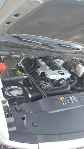

My Engine Cover showed up yesterday. I had just finished detailing the truck and slipped it on. Figure I'll leave the Cadi. emblem on for now. In the future maybe a BMW Roundel.
I shot mine today with Krylon... The cady emblem was the first to go for me... Waiting on my bowtie from AZ, went to CA, now in PA... WTF? Maybe it will find it's way home for Xmas...
