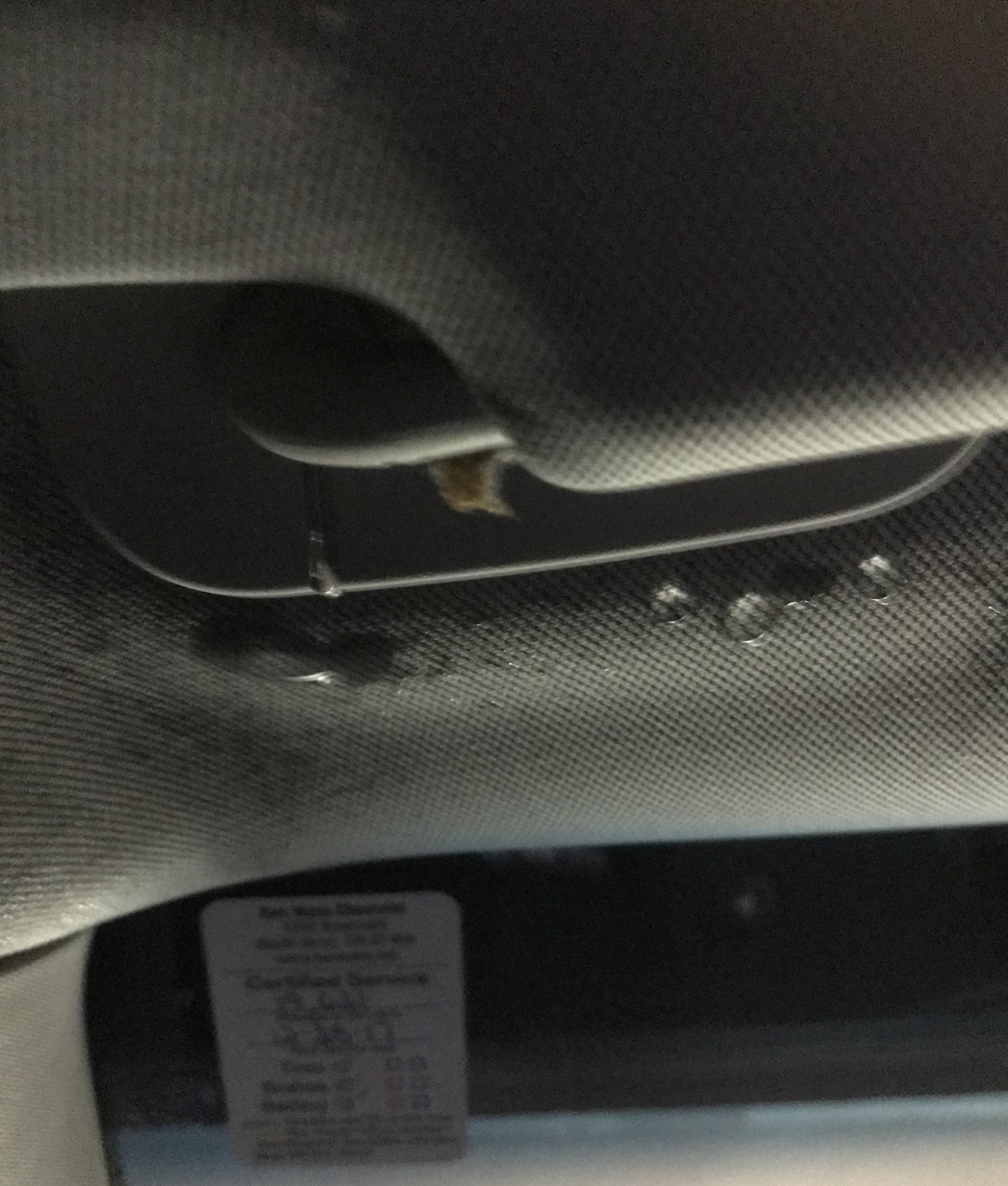

Roof Leaking. Water coming in at visor attachment.Thoughts?
I apparently cured the situation. I took the drain tubes off in front and used some clear silicone to make sure the fittings don't leak and put some around the gasket on my OnStar antenna, although I couldn't see where either of them were leaking. No leaks for the last week and we've had our share of rain!

my truck had both the shark fin antenna fail along with the sunroof glass seal. antenna water leaks are around the sun visor and A pillar, sunroof water leaks will be right above your head by the Bluetooth microphone and edge of head liner opening above drivers head. but have also heard about leaking windshields, and even a faulty weld in the roof seam. good luck.

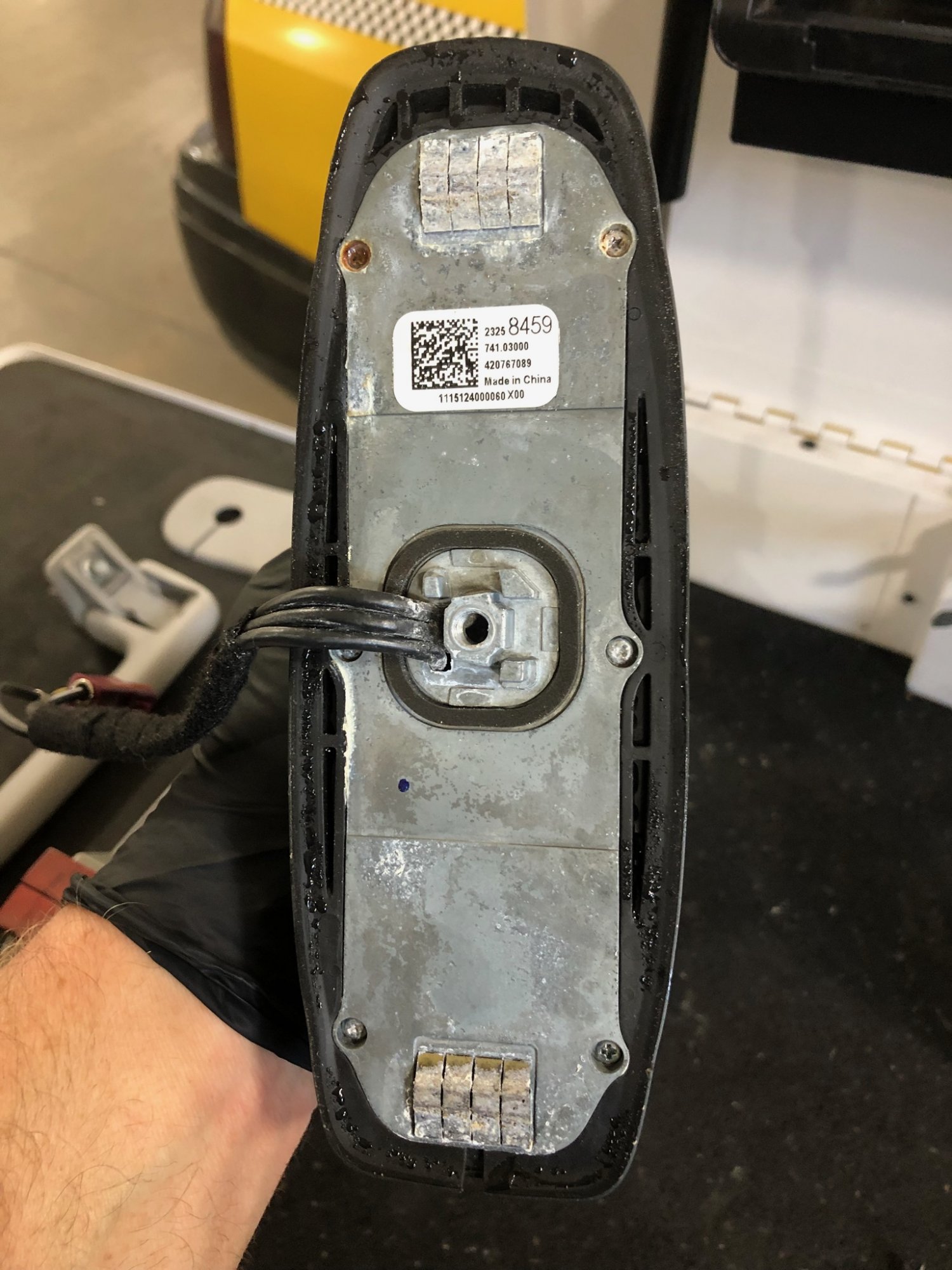

I got in my truck to drive to work yesterday and the driver side pillar and one spot under the onstar antenna were wet. Turns out the onstar antenna is secured by plastic clips from the bottom that can not be adjusted. They "sometimes come loose" breaking the gasket seal.
In order to fix the leak it is a new antenna. $130. 1.5 hours to put it in, time to diagnose, all in $530.

New here.  I found this forum because I too am having the leaking antenna base on my 2015 Silverado Duramax 2500.  Noticed the problem back in 2016 luckily while under the bumper to bumper warranty. The original leak was coming out of the pivot point for the visor. Took it to the dealership, they said it was a pretty common problem and they fixed it.  They had my truck for 7 days....apparently the headliner and windshield had to be replaced because they broke them when pulling them out to get to the antenna base.  Problem seemed to have been fixed...until a few days ago when I noticed a big water stain above the a-pillar drivers side. Water also poured out onto my foot from under the dashboard when I turned a corner last night. Apparently it is leaking all the way under the dash and coming out over the e-brake pedal....where a ton of dash wiring goes through.  I contacted the dealership to see what they would do to fix the leak that they apparently didn't completely fix the first time ...only to find out the GM knows about the problem but they won't do anything about it, and the dealership won't honor the warranty they said they gave me to extend on this particular issue.  My bumper to bumper warranty expired 4 months ago!! So I am supposed to pay the dealership $1200 dollars to keep it from raining in my $50,000 truck.  That doesn't even cover replacing the headliner...only labor, a new windshield, and the silicone added under the xm antenna base.  I AM SO PISSED!!!
I have contacted GM customer service and supposedly have been handed my case up to a senior advisor. RIIIIIGGGGGHHHHT.
Does anyone have any suggestions on how to repair this issue.  Is it ok to completely seal around the antenna base from the outside without taking out the headliner?  Does heating the inside of the truck dry everything out enough that it won't mold on the inside?

Get Gorilla 100% Silicone clear sealant. The company site states that it is OK to use on auto, metal, and plastic. I did a thin bead and spread it around with my finger around the shark fin. With it being clear you can't notice it. Also, it is not going to yellow or crack so that is a benefit.
While at it, go ahead and do the same for the top and both of the sides of third brake light. I have seen people state theirs is leaking there as well.
I did this quite a few months ago and have since taken my 15 silverado through a touchless car with 0 leaking issues which it did leak before.
