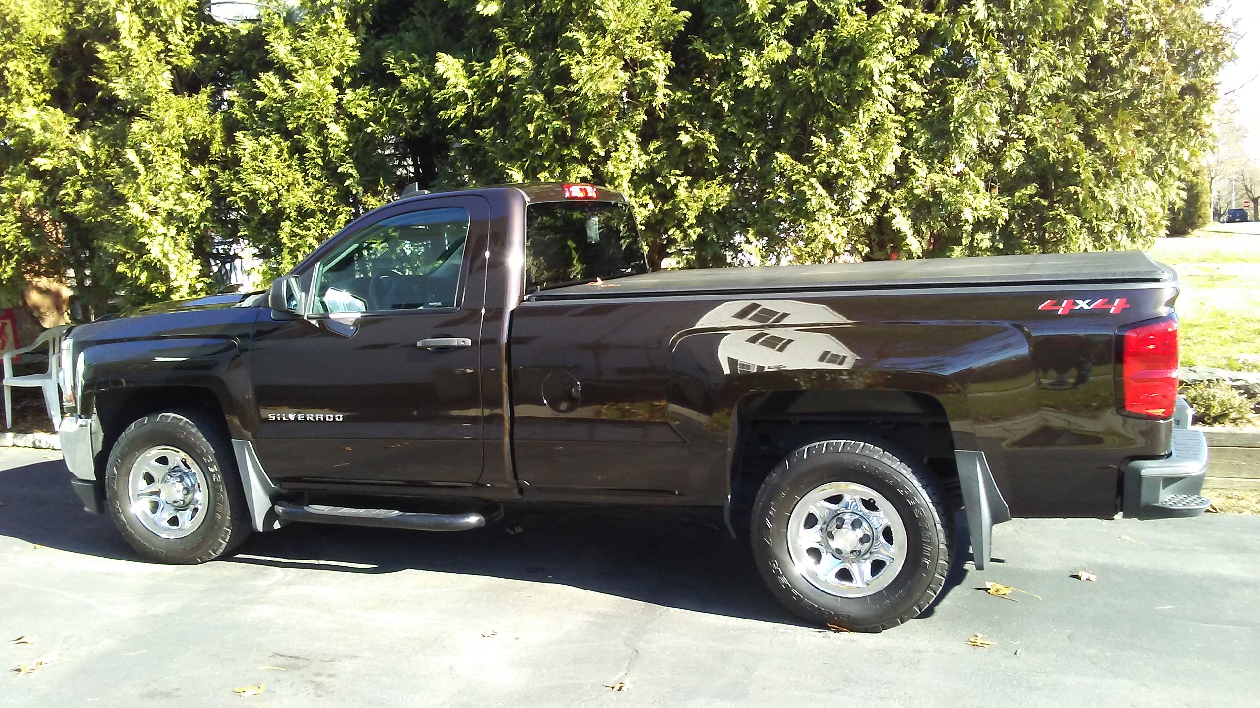

Project AMP Steps complete and im super happy with results! Took some time and a little trimming but they came out great [emoji1360] defa805dc085d2892c68ce632cdca74e.jpg

Very nice,  been thinking about attempting this for a long time. would appreciate more pictures of the mounting locations and any how to advice. Thanks

Nice! I didn't know they made them for the reg. cab. Gonna have to look into this.
ill def get some photos of the mounting points to post here. Amp does not make a specific kit for reg cabs...and i really couldnt find much info online for reg cab installs......
I saw a few posts online here or there but not much details on RC install
i ended up rolling the dice a bit and purchased the amp kit 76154-01A which is the plug N Play kit for the GM Crew Cabs. Everything installed just fine, electrical/plug n play was easy. The passenger side mounted right up, nothing in the way
but on the driver side, I had to put the linkage with the motor towards the front and then the back linkage area I had to trim a few spots (which I was a little hesitant at first) but ended up being ok.
I wanted to mount the linkages as wide as possible so I could extend the step a bit towards the bed and be able to use the step to reach into the bed if needed.
I then trimmed the boards down to 65 inches (amp has a youtube vid on trimming the boards)
so just took my time with that part.
ill post more pics soon

Nice job on the install. I'd be interested to see the photos. Can you also post a pic of the steps tucked in?
