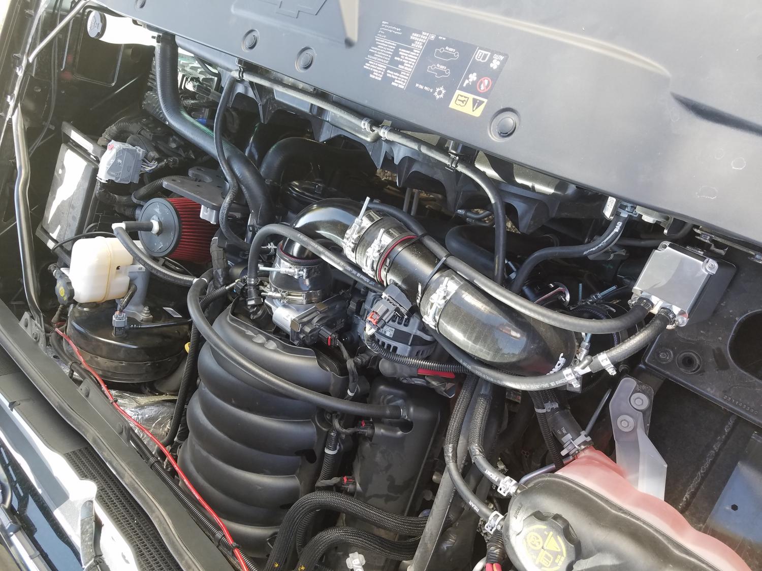

Haven't posted lately. Just got the wheels and rear QA1 shocks on along with the center console swap (Best money spent, lol). This weekend I will be doing Caltracs and hopefully, if the parts come in, the L86 Manifold swap with a LT1 ported TB.
How did the intake job come out?
Good, I just got it done this weekend, along with a bunch of other crap. Did the rear brake conversion to the small brakes due to having to run the spacer on the Race Star's which is fine since I can now run a 15" rear. Swapped in the manifold and ported LT1 throttle body along with installed a WB for tuning, and the icing on the cake was I got the intercooler and associated piping installed, brackets, MAP sensor and everything else I need to throw a blower on, just didn't realize the blower I had in storage was a reverse rotation (Should of known since it was for my C6) so once I have a new blower in it will be supercharged. In the meantime I got everything tuned in NA for the new MAF tube size, MAP sensor, manifold and TB so it should be straight forward once I do toss the blower in.
