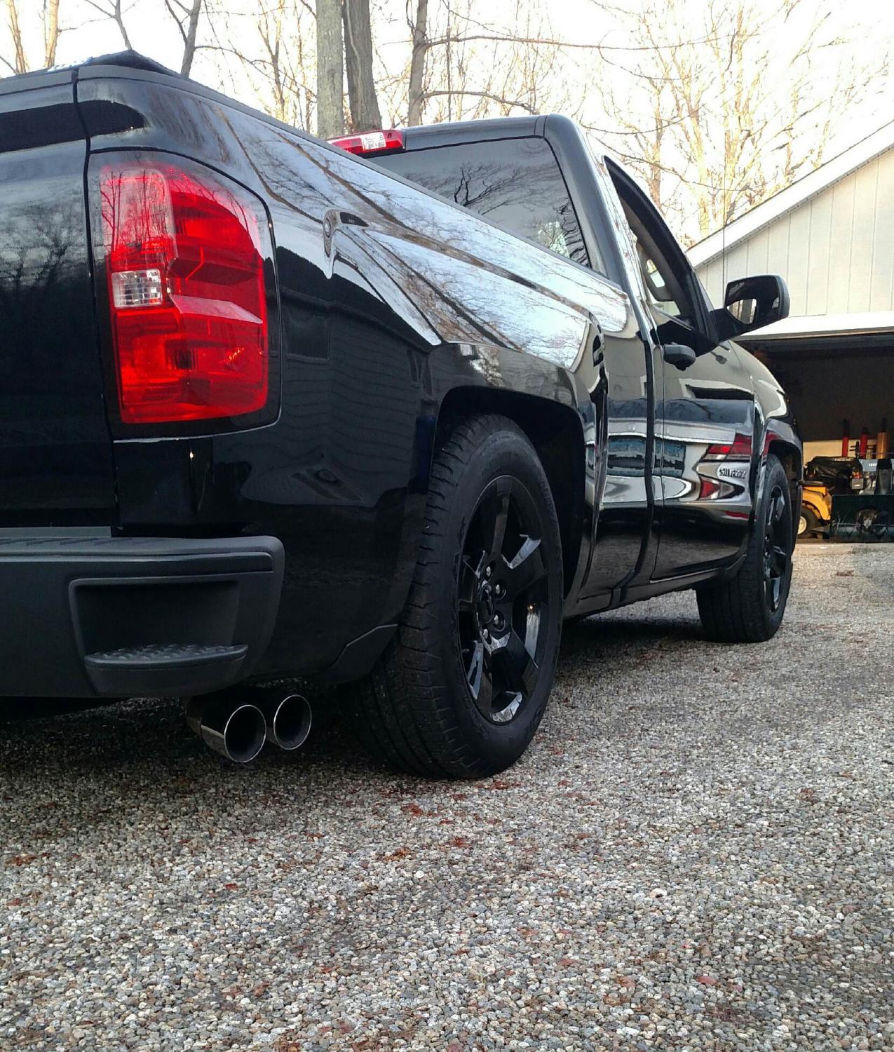

Haven't posted lately. Just got the wheels and rear QA1 shocks on along with the center console swap (Best money spent, lol). This weekend I will be doing Caltracs and hopefully, if the parts come in, the L86 Manifold swap with a LT1 ported TB.
How does the 17 fit in the rear? I'm getting racestars but some people say you.have to grins the little caliper bold in order for the 17 to fit
They hit on our trucks. I have ground the head of the banjo bolt down some, but haven't verified clearance with just that as I have a 1/4" spacer on the rears right now and that gives you clearance. I will have it up on the lift this weekend and will check fitment without the spacers and let you know if there are any other mods needed. I'll be converting to small rear brakes some point this summer is my guess to run a 15" rear.
