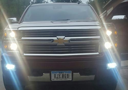

I literally just created an account to thank you all for the help. I can't even describe how easy this was to do... I have some of those smz vled headlights on back order so I'll post an updated picture then, but this is how it looks now... And I dig it
