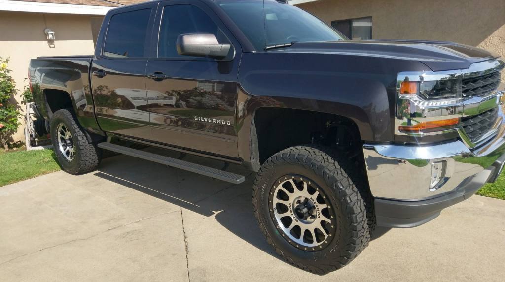

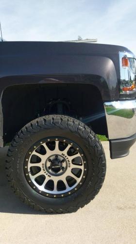

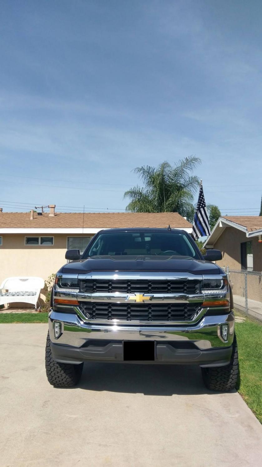

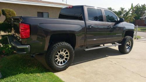

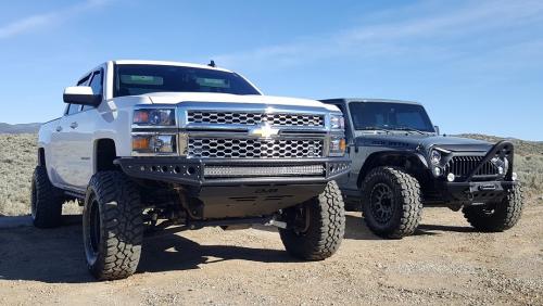

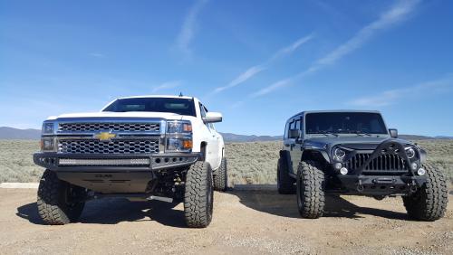

Hello,
New to the forum as I just signed up today but have been lurking since I got my truck in late 2015.
My wheel and tire set-up are as follows:
17x9 -12 offset Method Race The Standard in Matte Black
General Grabber X3 35x12.50R17 - Red Lettering
1 3/4" hub centric spacers are in installed on the rear axle
Truck is currently lifted 6.5", no rubbing
Edited by Tedro
