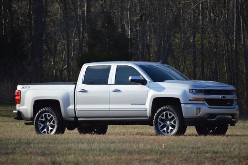

2016 Silverado Z71
2.5 inch front/ 1 inch rear with bilsteins all around
OEM GMC A/T 20x9
33/12.50 Toyo M/T
Rubs pretty bad on turns at about 3/4 lock (pulling out of parking spots, etc.) - more forward than reverse....strange?
Rubbing is consistent on the UCA's on both sides (due to bulky stamped steel arms), and that seems to be the only point of contact.
Need recommendations from anyone running wheel spacers please! are the hubcentric ones with the studs the best option? what about reliability? Wheel spacers scare me, but love the look of my truck and as it sits and it took me forever to find these wheels at a good price so they are staying....

That looks awesome. Too bad it's rubbing bad. Would new control arms solve the problem?

Thanks man, I appreciate it! It really is a shame that its that bad. Planned on a narrower tire, but came across these for 1k with stickers still on them so I couldn't pass it up. Now I'm here.....looking for information on wheel spacers......hah

The correct answer is to get narrower tires or rims with more negative offset. There is a sticky about spacers....BORLA seems to be the best, but run them at your own risk. They work great, until they don't.
