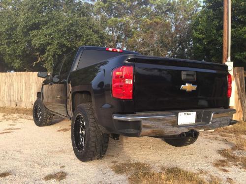

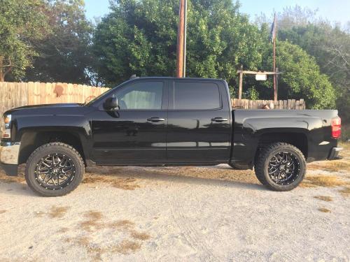

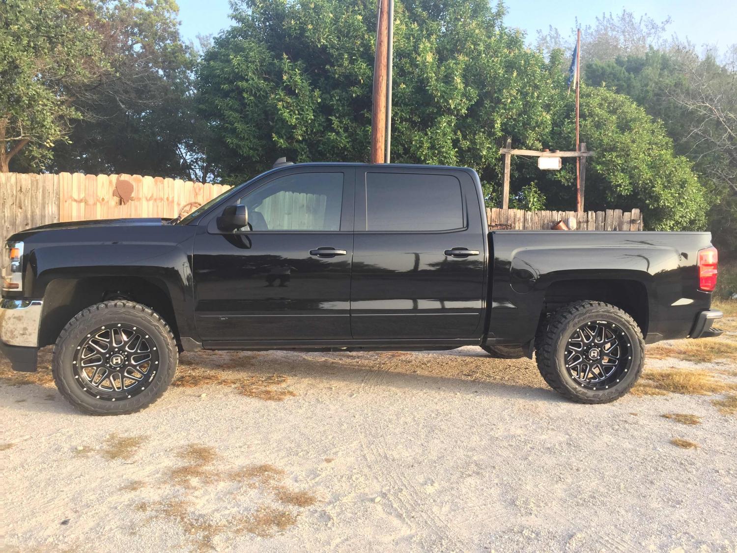

Sbaer2012 Posted October 30, 2016 Share Posted October 30, 2016 295/70R17 Toyo RT 17x8 +0 4.5"BS XD RG1's any more pictures from front or another angle? i have a cobalt blue sierra...looking to get 17inch fuels on a 2 inch level with 1.5 BL... wasnt sure how lifted trucks with 17s would look though. planning to run 285 or 295s as well. Quote Link to comment Share on other sites More sharing options...
StretchASU Posted October 30, 2016 Share Posted October 30, 2016 any more pictures from front or another angle? i have a cobalt blue sierra...looking to get 17inch fuels on a 2 inch level with 1.5 BL... wasnt sure how lifted trucks with 17s would look though. planning to run 285 or 295s as well. Quote Link to comment Share on other sites More sharing options...
StretchASU Posted October 30, 2016 Share Posted October 30, 2016 I'll snap a few more tomorrow. I actually prefer the look of the smaller wheel, as long as it's something with some substance to it. These, Raceline monsters, Walker Evans legends etc. not a lot of little spokes. That's probably from my off-roading background too. No offense to anyone on here with them, but just about every truck in my area has 20" Fuel Mavericks or something very similar and I wanted the complete opposite. 2 Quote Link to comment Share on other sites More sharing options...
