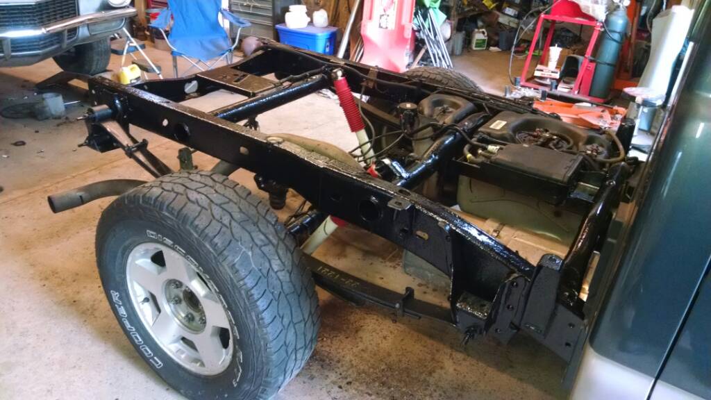

Cleaned, and painted the inside frame rail where the gas tank goes. The Chassis Saver Paint I bought for this is good stuff. Goes on, and sticks like glue. Dries nice too, and seems durable.
IMG_20140809_174807480_HDR_zpsefad4df8.j
Some shots of it this morning put back together. Still have to finsh prep work, and paint work on the frame.
IMG_20140810_105849205_HDR_zps1dbfb387.j

I actually brushed it on. My original plan was to have my dad spray it on, but I couldn't find the S8 reducer locally. I didn't want to use anything besides the S8 just to be safe.
Decided to finish painting my frame today for the most part. It has 2 full coats on it now. I still have a few spots here, and there to hit yet, and I think I'm going to give it a third coat.

Thanks. One more coat of the Chassis Saver, bend, flare, and install the brake line, and buy and install a new ACDelco Fuel Pump is all I have left to do then the bed will be going back on.
