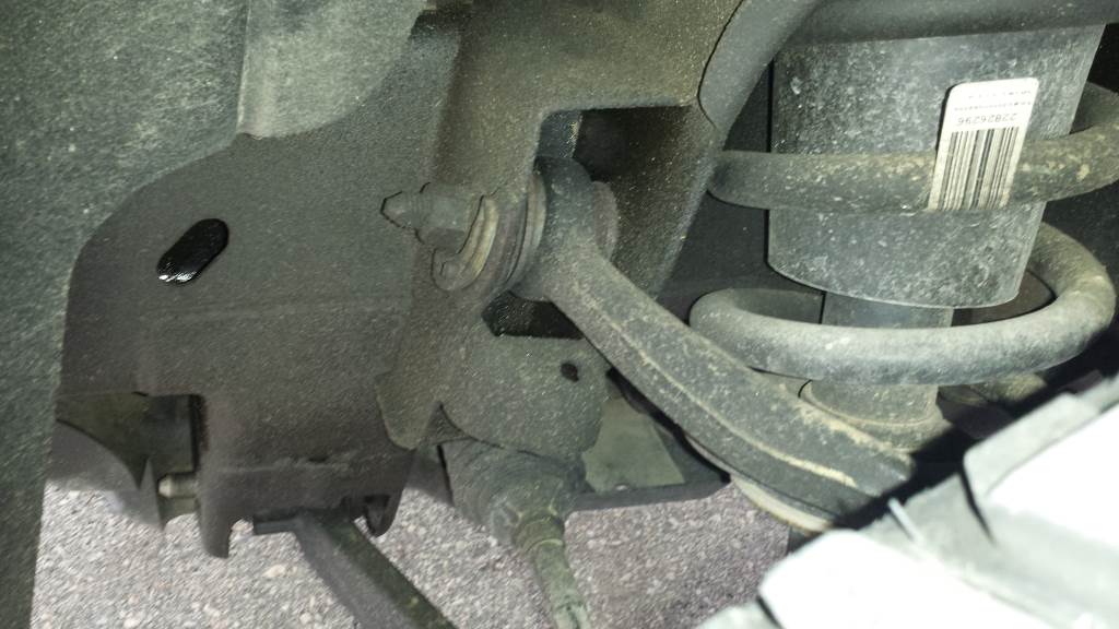

What would you guys say is the best way to maintain a new frame from the start? Is it actually bad to pressure wash or hand wash the frame, as it could remove the wax coating, thus losing our protection?
I wanna wash it and keep it clean but I don't wanna strip off the wax...

I personally would just hose everything down with a standard garden hose. That's always worked well for me in the past. Then get a can of the rubberized coating (see link below) to touch up bare spots as you go to keep the frame protected. If you have the issue where sheets of this wax coating are just falling off left and right, then you should push to get the proper TSB repair done.

And my frame didn't look anywhere as bad as the OP's. The way the shocks are rusted too almost looks like he drove through something caustic, more so than the brine or salt. I say this just from the perspective that the shocks are made by someone other than GM and they are rusted too. They are laso painted, not waxed. Just strange.

No the shocks will look like garbage in general. These aren't genuine "from the Rancho factory" shocks they're Rancho shocks made specifically for GM trucks which means they were the lowest bidder to GM and this is the crappiest product Rancho makes. Mine look rusted as well and we've hardly had any snow this winter or chemicals on the road. GM is just using lower quality parts and lower quality metals that rust easier and more quickly than past model years to cut costs.

Very possible on Ranchos part. My shocks were okay on the Silverado, just a little rust on them after the winter. Looked a lot better than my frame. And I don't know where "laso" came from... Must have been a bad autocorrect or something...

Spray it with oil or fluid film once a year or twice a year.
I spray mine twice per year with Fluid Film. My frame has zero rust, it's just dirty from using it for truck things. I washed my truck once all winter. Some guys swear up and down that FF will make the wax fall off. As you see the wax is still there and actually it's holding up really well.
Do not put rubberized spray coating on. Research what rubberized coating does over on Bob Is The Oil Guy. It's the fastest way to make your vehicle rust.
Not sure on wax but for FF or oil, just spray it oil. It'll soak through thinner dust. You can even spray it on any light surface rust and it'll prevent the rust from spreading or advancing deeper into the steel.

This is the GM approved stuff: https://www.daubertchemical.com/store/product-list/corrosion-prevention/nox-rust-x-121b
However I can't find any instructions with regards to how to prepare the surface of existing rust. The can just says "surface must be dry and free of debris" which I take to mean dirt or other large loose particles that can be brushed away. I plan to just spray it right over any surface rust. Out of sight out of mind right? Haha
