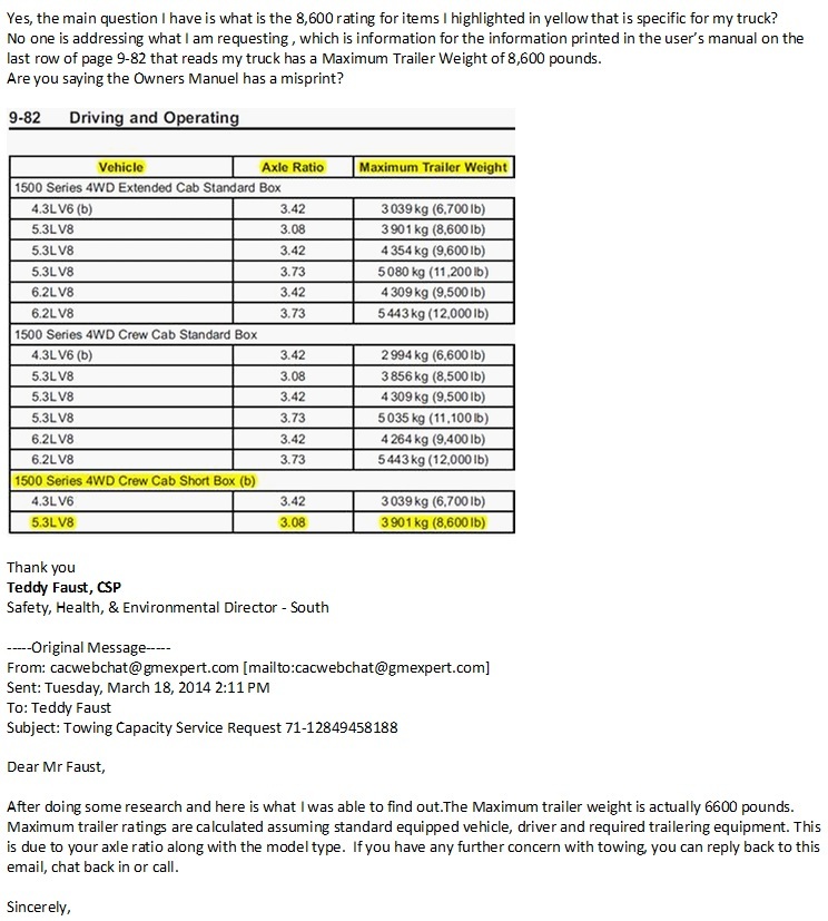

Maybe it is me??? Does anyone else know what I am asking because GMC has no clue!!! Read the email they sent and my response on top. If it's 6,600 and it is a misprint that would mean according to the owners manual, same truck with v6 tows more than a v8 & 3.08?? Makes no sense. I am ready to just say screw it and give up.

Lets see.
OM says that for 1500 crew - short box - 4wd:
V6 3.42 pulls 6700lb
V8 3.42 pulls 96001b (5.3L on next page from one posted above)
so a V8 rated more than a v6 when similarly equipped. (as expected)
But V8 with 3.08 pulls only 8600 in manual, so 3.42 out pulls 3.08. (as expected)
The owners manual seems consistent with these and other cab/box/rearend/engine/2wd-4wd versions.
However,
The ordering guide agrees with the gm response and disagrees with the owners manual.
Ordering guide shows TK15543 (4wd, 1500, crew, short (5'8") box, 3.08, 5.3L at 6600lb trailer maximum.
At the 3.42 ratio, ordering guide is 9600 and OM is 9600, so they are same for that configuration.
You can check your codes in the glovebox sticker. 3.08 is GU4 and 3.42 is GU6 is 3.42.

Customer service rep verified the manual that came with my truck was incorrect and it was changed to 6600 (100 less then v6) here is the link for the new manual
https://my.gmc.com/web/portal/knowmyvehicle?g=1&year=2014&model=1500_sierra&make=gmc
The other link in previous post, although currently on gmc site, is not correct.
