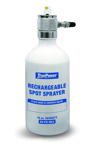

 To spray the ATF, I used a rechargeable sprayer that is pressurized with compressed air. I used a 2 ft spray tube that came with the cans of cavity wax that I sprayed inside my doors, rockers, fenders, tailgate. There are enough holes in the frame that I believe the entire frame is coated inside. The ATF seems to be friendly to the factory coating as I have seen no evidence of it pealing or softening as I’ve heard mentioned from folks using Fluid Film. Time will tell if my small investment in time and money was worth it as I plan to keep this truck for a while.

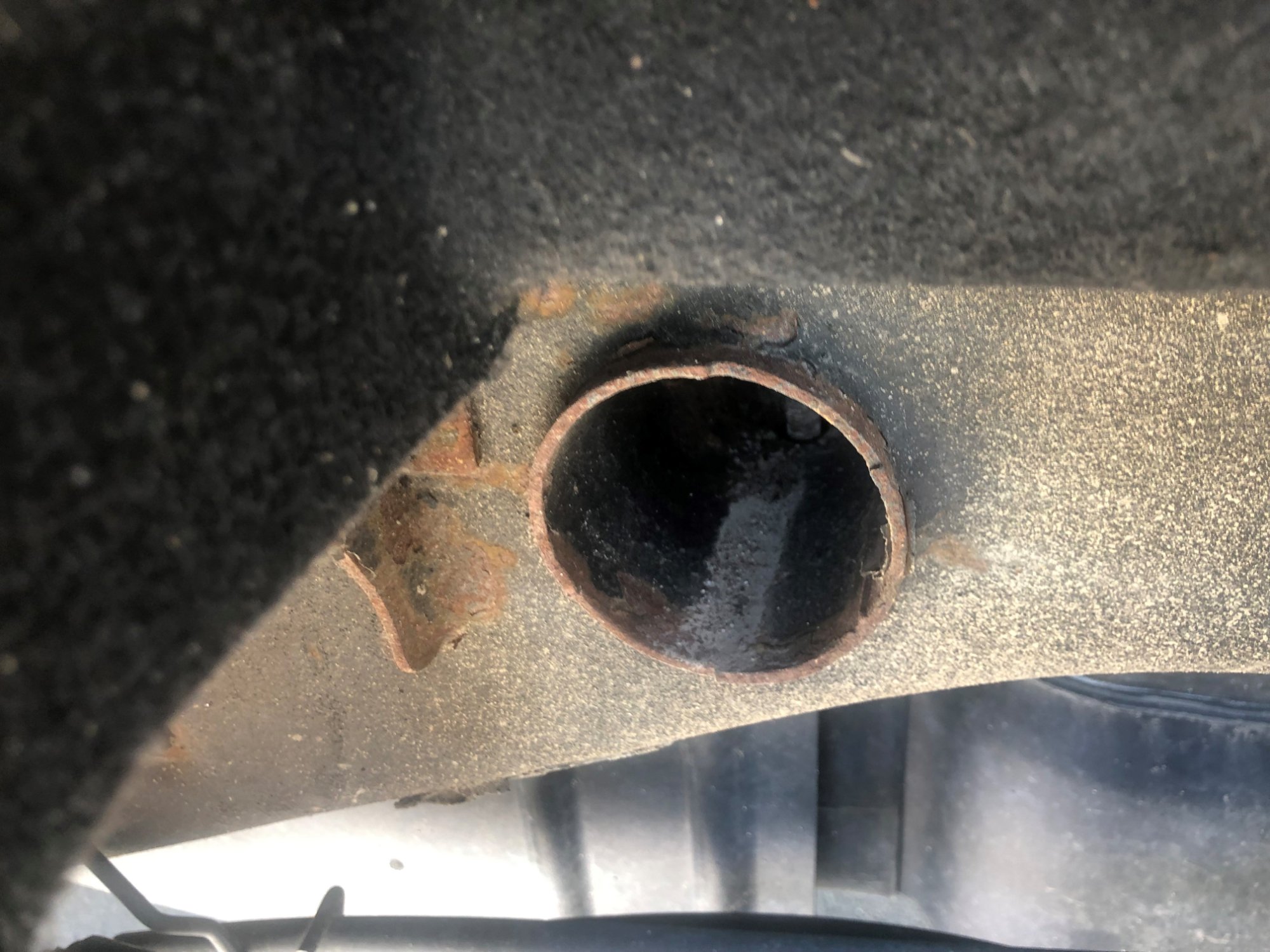

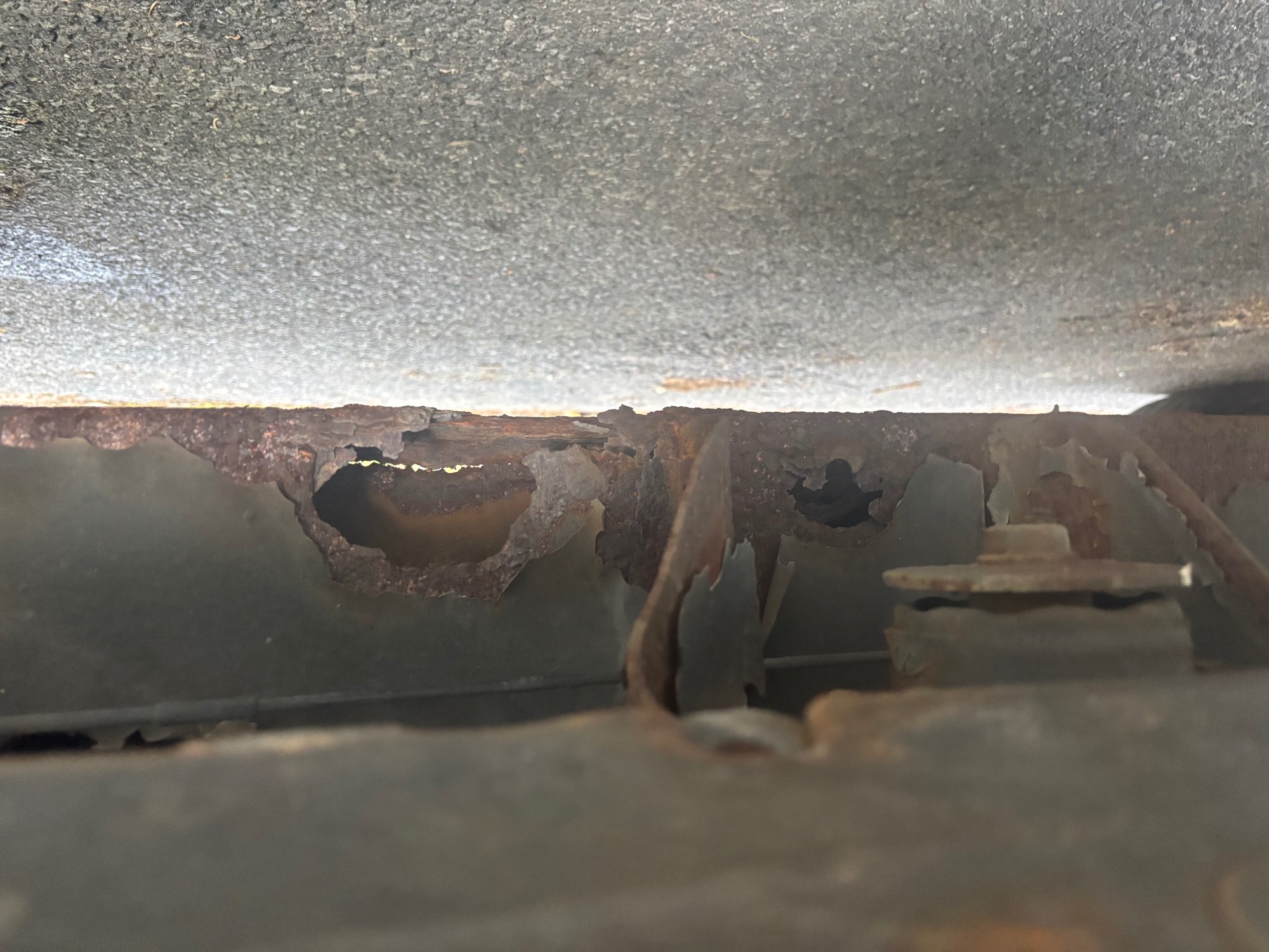

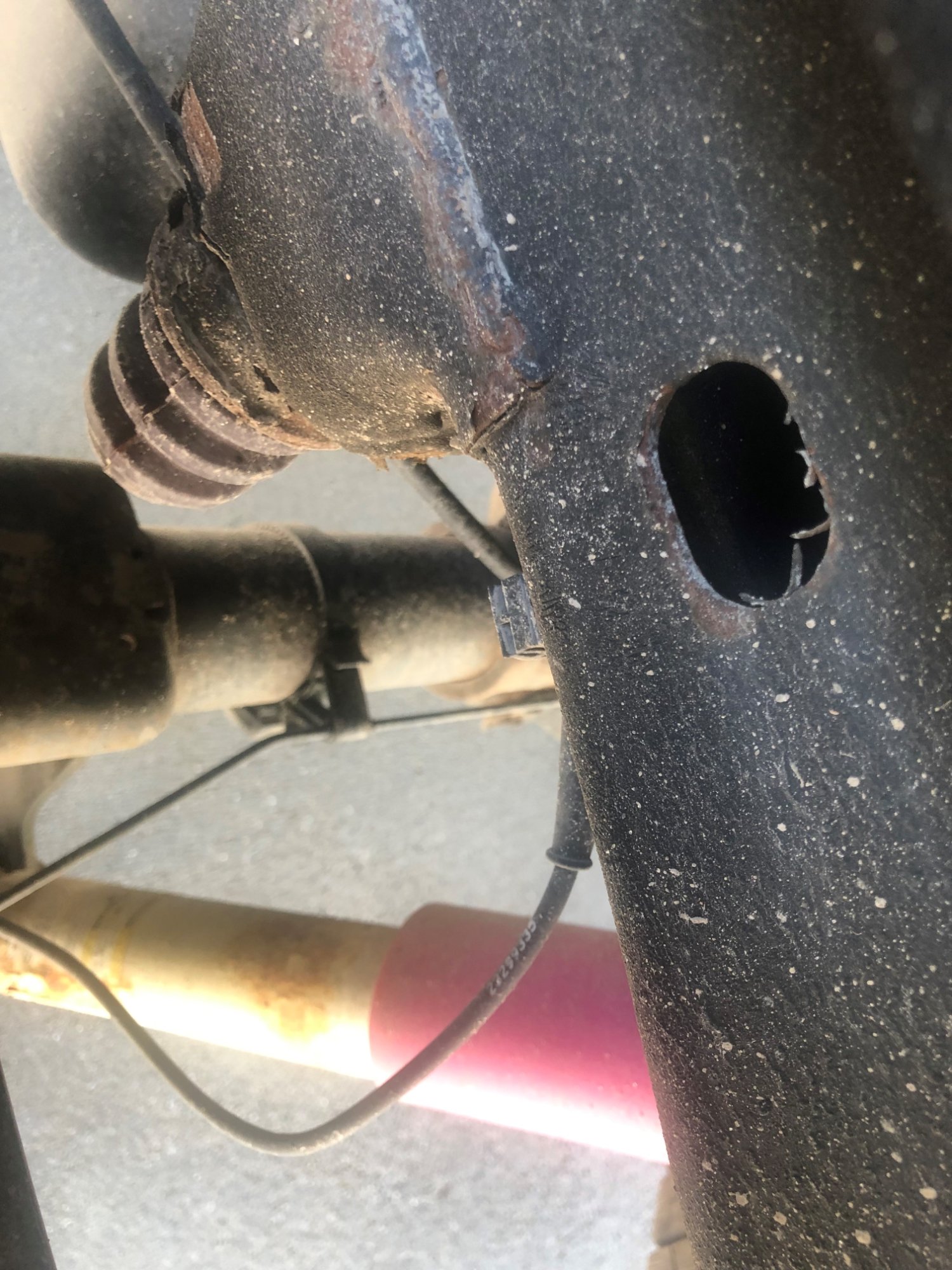

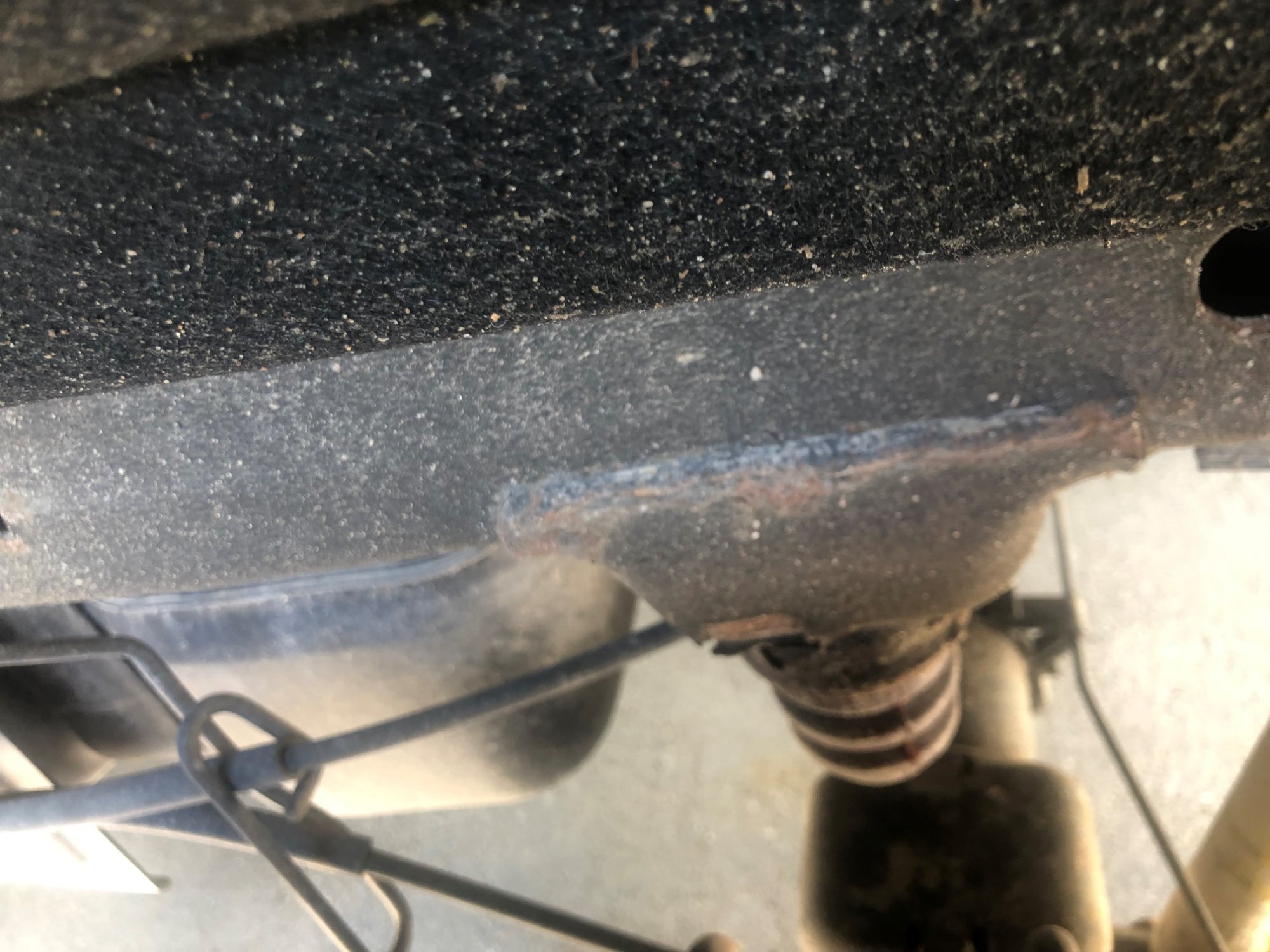

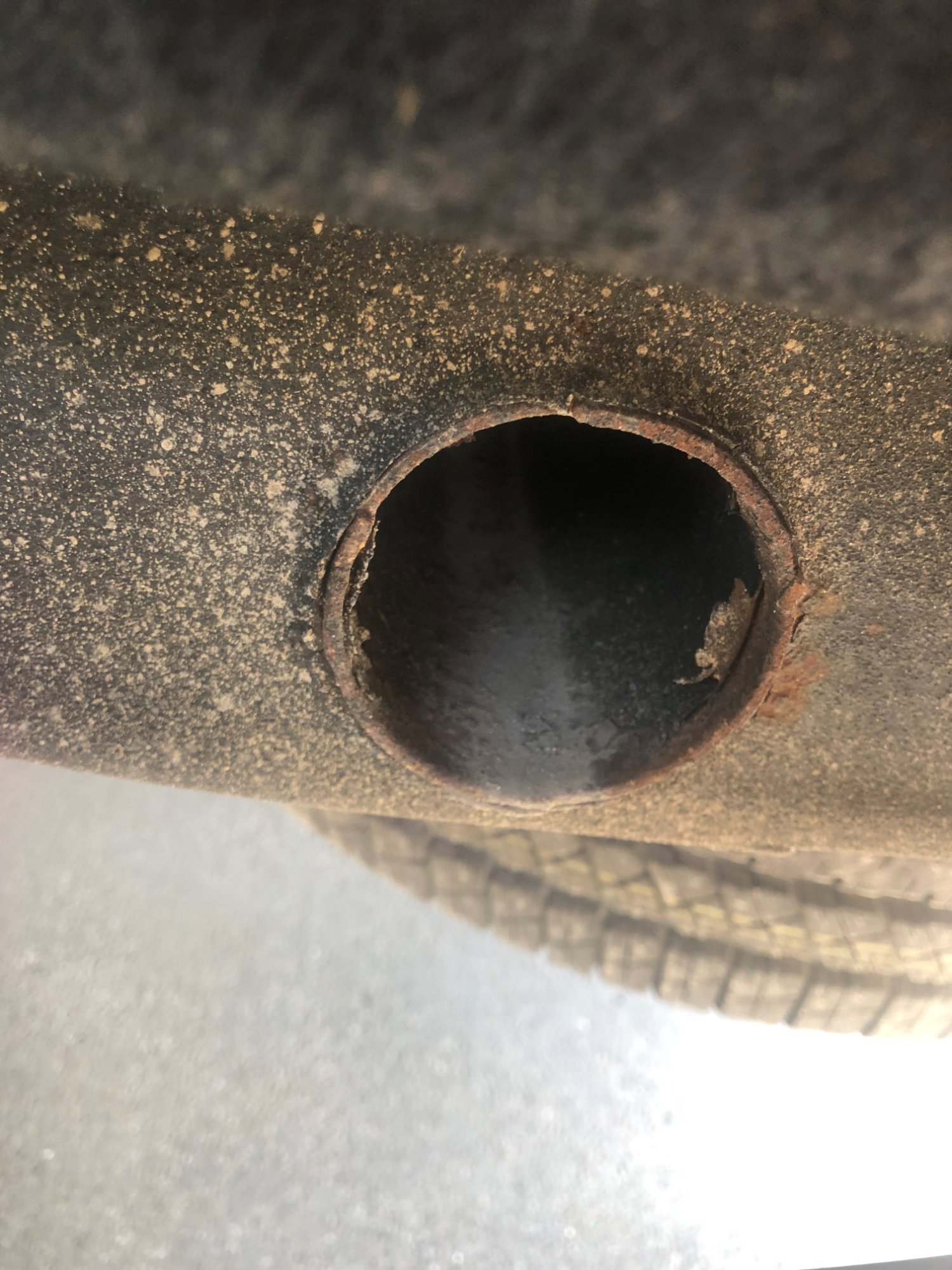

2018 Sierra, 30K miles - in addition to the rusting frame, which seems to be addressed in a service bulletin, has anyone experienced rear shock rust and color fading? The upper shock is now pink and lower portion is rusted so not very attractive. In quick search, it seems that the frame rust issue is largely cosmetic and involves an isolated # of K2 trucks. Wondering if they are all trucks out of a specific plant or geography? Was even thinking maybe flood/salt water (Hurricane Harvey or similar). Any insight would be appreciated.

You can't stop rust once it's started. Unless you grind it off.
Use rust cure 3000, rust check etc.
