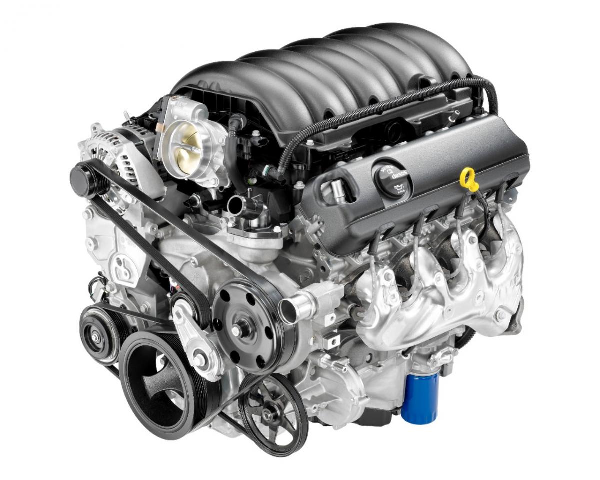

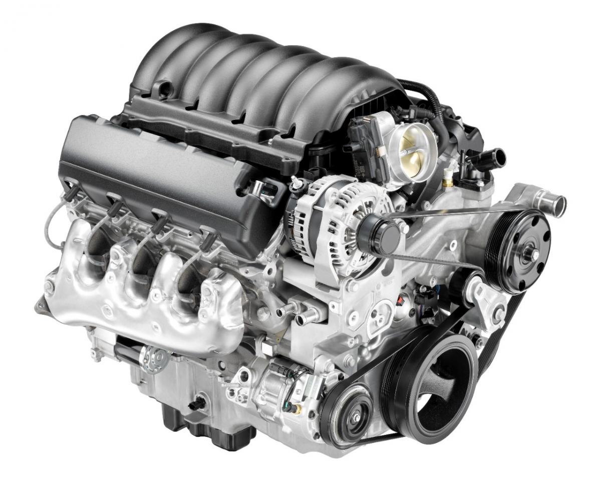

markpetersonii Posted February 7, 2014 Share Posted February 7, 2014 I thought I would create a thread dedicated to the new 6.2 that are in the new Silverados/Sierras. This way all the new info or anything that may come out can be posted in here. Also, some questions and help in here can be consolidated. Here are the specs of the engine, from GM: http://media.gm.com/content/media/us/en/chevrolet/vehicles/silverado/2014.tab1.html#engines2 Type: 6.2L V-8 Displacement (cu in / cc): 376 / 6162 Bore & stroke (in / mm): 4.06 x 3.62 / 103.25 x 92 Block material: cast aluminum Cylinder head material: cast aluminum Valvetrain: overhead valve, two valves per cylinder, variable valve timing Ignition system: coil near plug, platinum-tipped spark plugs, low-resistance spark plug wires Fuel delivery: direct fuel injection with Active Fuel Management Compression ratio: 11.5:1 Horsepower (hp / kW @ rpm): 420 / 313 @ 5600 (SAE certified) Torque (lb-ft / Nm @ rpm): 460 / 623 @ 4100 (SAE certified) Recommended fuel: regular unleaded Maximum engine speed (rpm): 6000 Emissions controls: close-coupled catalytic converter, Quick Sync 58X ignition, returnless fuel rail, fast-response O² sensor Estimated fuel economy (city / hwy): 15 / 21 (2WD) 14 / 20 (4WD) Link to comment Share on other sites More sharing options...
