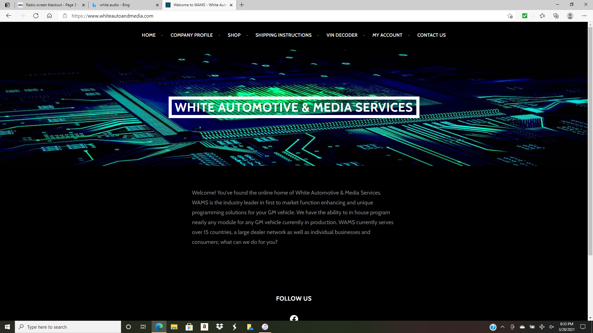

 Also WAMS (White Audio and Media) can reprogram used modules to work in your truck to save some money. Their customer service is top notch.
