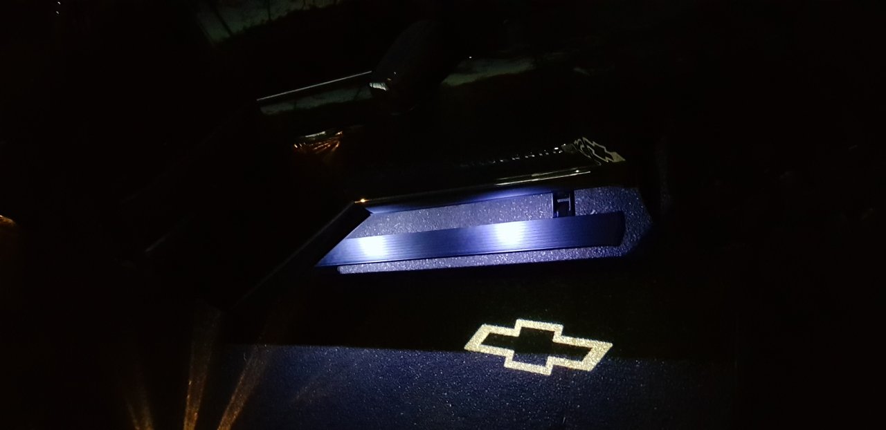

For a while, I had the door handles installed with just the regular LED that was in the door. I did a whole retrofit and bought some Profile Prism Sequential LED strips(6"). Crossed my fingers and dug(dremel/grinded) out the backside of the door handle to fit the LED strips, sealed them up and wired them back up. Now they come on with park-lamp(white) and turn signal. I did also wire up the regular LED to come on with the puddle lamp, but at night, the park lamp comes on, so it outshines the OE LED in the door :(. I did keep the option in the door to switch it out to that if the normal park-lamp LED was too bright(unless I get complaints, it' the bright LED :D ).

Thanks man! I had the parts sitting around giving me the stink eye to do the retrofit for almost a year. Due to the covid stuff going on, been working from home since March.. so was taking my time and didn't need to drive the truck really, so it could stay apart for a while.. haha!  you can find sellers that do more crazy stuff, but I had the time and wanted to learn.. plus, I like how the Profile Prism sequential flow(chasing) These things are BRIGHT!

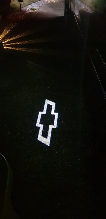

Installed OEM Chevy Projection puddle lamps(need to tweak the position, not straight with the body). These are for 2019-2021, but fit my 2017.
https://www.gm-trucks.com/forums/topic/241697-puddle-light-kit-with-gmc-logo-projection/
Chevy projection Puddle Lamp

I ordered some of those 3-4 days ago waiting for them to arrive, how do you plan to straighten them?
It looks like you can just notch a little off  of the side(left or right) of where it clips into depending on which way it need to turn. It's not that far off, so it wouldn't be that bad. I did have to shave a little off the edge on one side, as it rubs/pushes up against(looks like a the housing for the mirror motor?) and it wouldn't sit flush. After shaving off a little, it sat flush. Per paperwork mine came with, the stickers were supposed to be Purple(DD) and Orange(PD), the Orange(PD) looked yellow to me.. But yellow in the paper works was for Cadillac DD.. :D
**Updated to show after notching out the puddle insert to line up with body.
