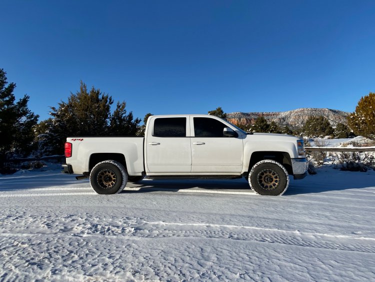

I’ve seen it done with Bfg ko2s before on 0 offset. I’m running 0 offset as well and the 295s really only needed the plastic piece on the wheel well trimmed down a tad and the liner pulled back. 285/75 is about .7” bigger (if going off of the website) so shouldn’t need much more trimming than a 295, but looks to fill out the wheel well more.
There’s a guy on here running 285/75 ko2s on just a bilstein 1.8” leveling kit on 0 offset methods and he didn’t have to trim much. I’ll definitely be going with 285/75 next go round. Here’s a pic of my truck with the 295s for reference

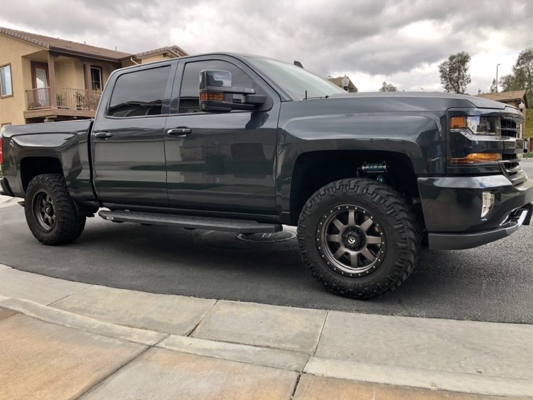

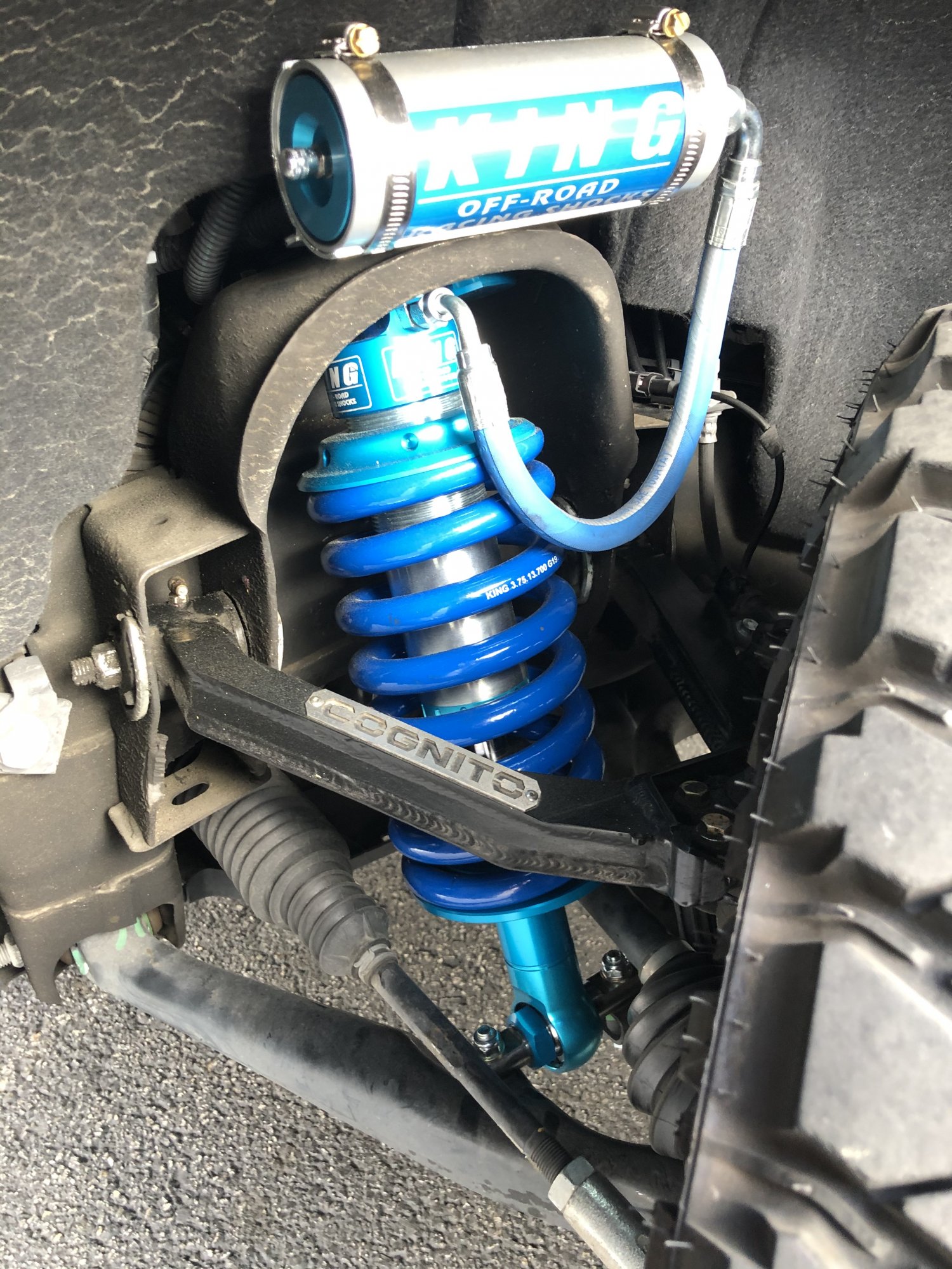

Everyday driving not much of a difference.   I do feel less chatter and the truck feels a little more planted on the road.  I did take it on some dirt roads this weekend and that'a where you really feel the difference.
