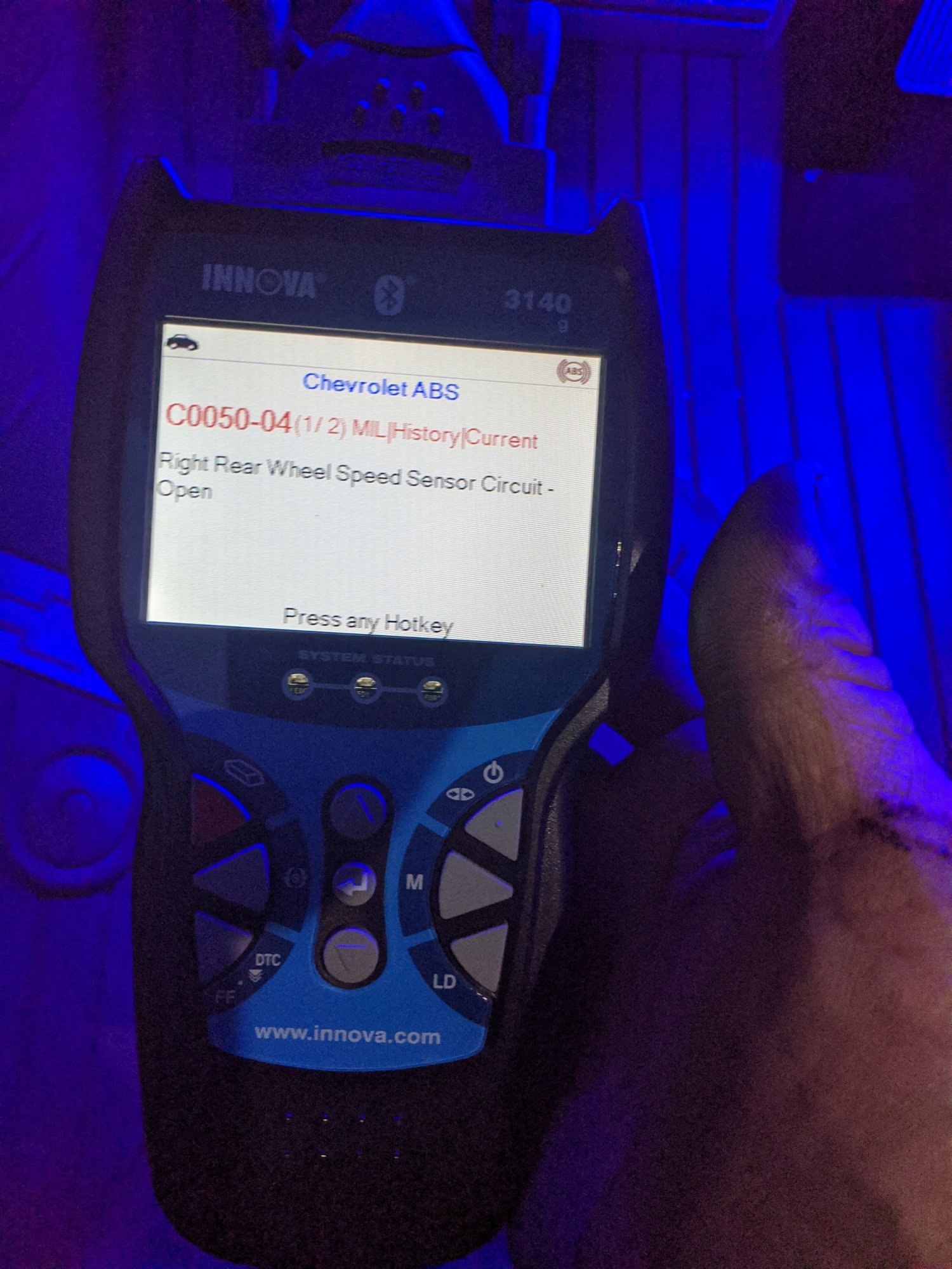

when I bought this truck it had already been lowered, I fixed some stuff that I found when I first bought it that the careless previous owner or installer overlooked, I thought I was all set, today I hit a speed bump kind of hard and bam abs/service traction/service trailer brake came on, thought I had maybe broke the trailer brake controller, got under it and and found that whoever did the drop ran the passenger side abs harness between the axle and the frame so if it bottoms out it pinches the wire. confirmed with a scan, I was surprised to find out the  sensor is pretty cheap like $20 so I don't have to fix the harness I will just grab a new one and route it correctly.
