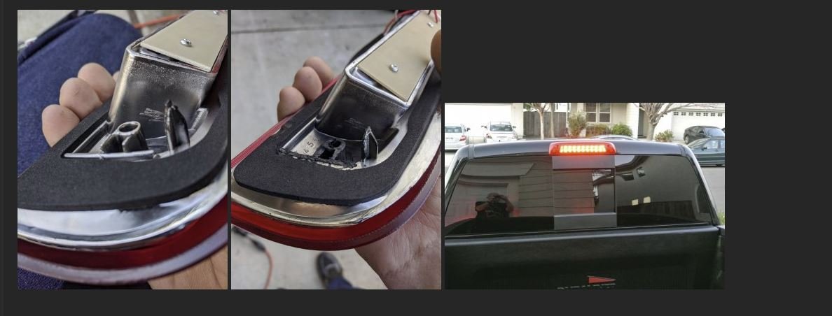

changed the 3rd brake out with a full red led lamp, modified it for no cargo lamp function I never use it anyway, I discovered why these china lamp housings leak, the screw mount hole protrudes out farther than the weather seal, so I used a dremel and trimmed it down to the same height as the oem one and now it fits perfectly. I did end up cracking the housing tightening the screws down so I have another one on the way but it works good once I corrected the wire harness it was completely backwards from where it should be out of the box, typical for china junk.
