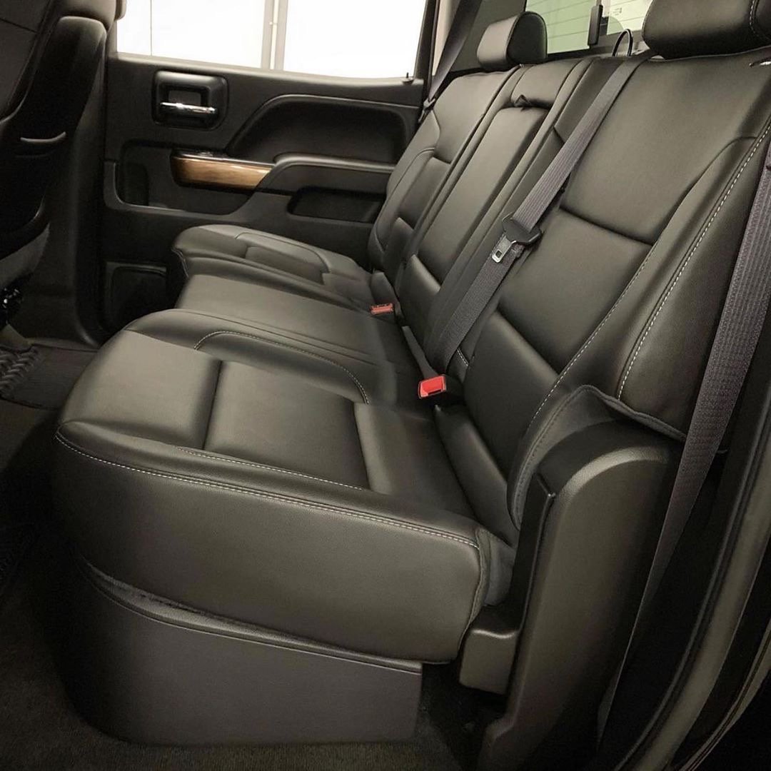

1 hour ago, PAPER said:
Do these box's fit with the rubber
All-Weather Floor Liners
SOME OF US HAVE IN ARE TRUCKS ???
Not a clue my friend.. there might be info on the website. Truckbass.com I mean how tall is the liner? 1/4? This isn’t my truck but this is the same enclosure under a ‘17 crew so you can kinda see the fitment.34DA1D5F-FAF0-45B2-A232-2A0FF4B4501A.thumb.jpeg.63ad4cff967c77c4b6789042dce1469c.jpegCDA73711-904C-4070-BB6E-4DE68F0ADC80.thumb.jpeg.c02bc36126320a90a76f72e5362ef1b7.jpeg
Thanks for the reply , I'll check the site when I have a minute ...
