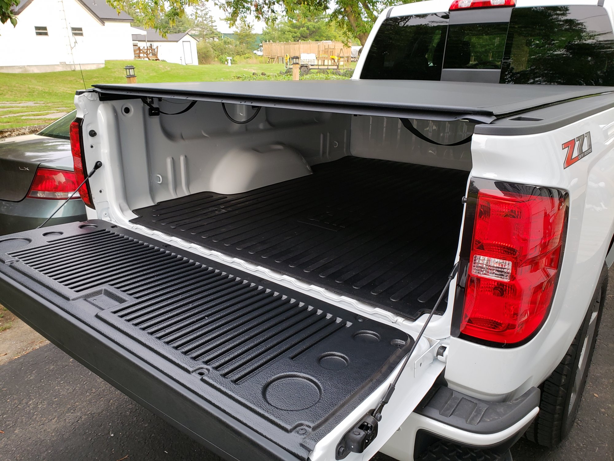

First post here all.. just left the Ford club and picked up a new Silverado Thursday.. mods so far include bullring tie downs in the bed, drivers side assist handle, Tyger tonneau cover, GM rubber bed mat, GM plastic tailgate liner (dealer gave it to me for free! - Ford never did that) and a few more to come. Took it for a 400km drive today and averaged 9.6/100km .. got a total of 450km on the truck so far.. really impressed with the mileage of this truck.

Congrats on the new truck!  Just a heads up, if you use it like a truck and use the bed a lot, plastic liners will scratch up the inside of the bed and have rusting issues later on down the road. Line-x is a great option to prevent that.
Chances are slim, but it still happens and I’ll see occasional posts about it.

Thanks for tip about the scratches.. hopefully the rubber bed mat will keep the scratches to a minimum.. first truck with a rubber mat, my Ford had a plastic liner in it and ya they do move around and scratch underneath. GM didn't offer a rubber tailgate liner so I went with the plastic one.. and it was free so I couldn't say no to that!

I don't know how long you plan to keep the truck but be careful of then plastic liner as well. Those things are notorious for causing rust in the northeast.
They only cause problems when not installed properly or maintained properly. There has been a plastic liner in the bed of my 91 since new, and other than the scratches the bed is perfect, no rust at all. Take it out every couple years, clean and spray some undercoating or ever just a heavy weight oil, then put the liner back in. And the bed will last for ever.
