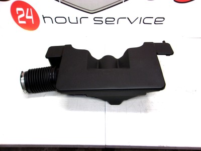

Has anyone performed autopsy of oem air intake tract?
It contains some sort of baffling technology to eliminate noise and I was curious as to the air path and amount of restriction.
This piece
  Image result for 2017 silverado 1500 air intake baffle
