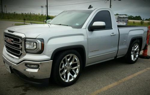

2015 Sierra
Combination of Belltech and DJM to give a 4/7 drop. Goes back in for air assist in a week so I can still haul a race trailer (which is the whole reason I bought one... can't put a Class 3 hitch on a CTS-V Wagon.)
  • Like 3
Looks great Croak. Nice & clean. What size wheel & tire setup are you running? Those are all terrain factory replicas right?
Thanks! Yes, they're 285/40/22 Falken Ziex tires on OE Wheels LLC reps. Couldn't justify spending 3 times as much on the OEM ones and then having to pay to strip the chrome and powdercoat them.
Edited by Croak

Got some OEM SEY 22" now I need to get smaller tires these 285/45r22 rub. Any suggestions?
I run a 285/40/22 Falken Ziex STZ05. Toyo makes the Proxes ST2 in the same size.

I rub a bit at full lock 4/7 on 22's. I'm guessing you'll have more issues because you're an inch higher (which has you covered vertically for clearance, effectively a trade-off with my measurements) but that still puts the tire an inch further out from the hub so you're an inch closer to rubbing on the inner side of the wheel well when the steering wheel is cranked.
:EDIT: Also depends on your offset, obviously. My setup is pretty close to stock offset.

Probably depends on your offset, I see you have OEM wheels. Mine are tucked like stock fitment and I haven't noticed any rubbing at speed but it rides like a covered wagon. I'll bottom out the bumpstops in the rear before anything touches there, I haven't managed to rub up front yet other than cranking the wheel in parking lots. Scraped the front air dam a few times.
