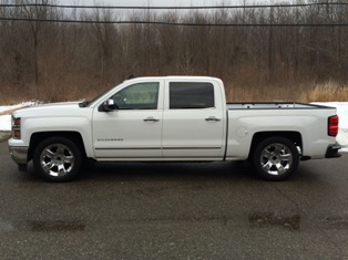

Finished mine today. 2" shackles and removed the block. I had a humming sound when accelerating onto the highway so I added 2* shims. I noticed I have that hum now at full throttle from 80-90 (toll road speed limit is 80), no other time and no vibrations. Cruising normally anywhere else or accelerating at any other speed and everything is fine. Anyone have any ideas?

Your rear axle looks off center...What's up with that?

My 2015 LTZ 2wd Crew with 6.2 8 speed.
