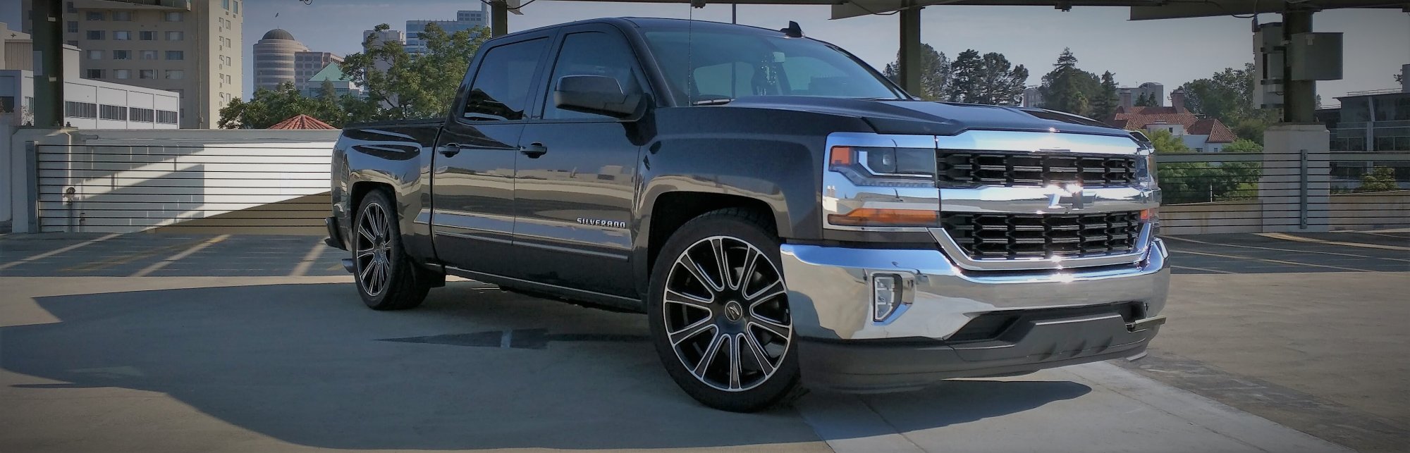

Couldn't resist any longer, it needed to be lower..
Im now at 2" front 5" rear drop, sits perfect, and the belltech shocks/struts ride 1000x better then the stock racho's
just in time for winter, had to put the winter wheels on this weekend :(

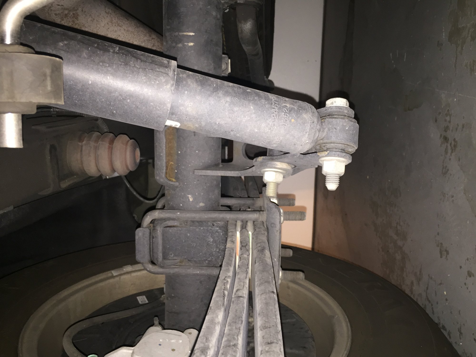

Do you have the lift hanger (shackle flip) installed ?

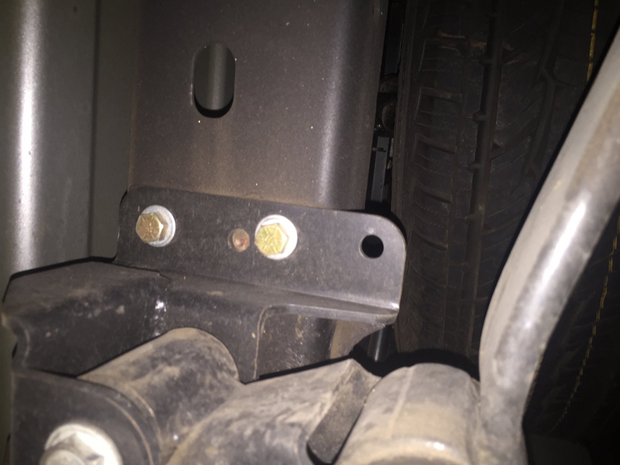

59 minutes ago, Nasty said:
Switch to the next hole on th4 shackle
Sent from my SAMSUNG-SM-G920A using Tapatalk
These next holes? Moving this up to the next holes will hit the bed?
Sorry for the sideways pics.

What kit do you have, looks like stock shackle?
that looks like you are already at the 5” setting at least on mine. Moving up to the next hole should drop you another inch either way
