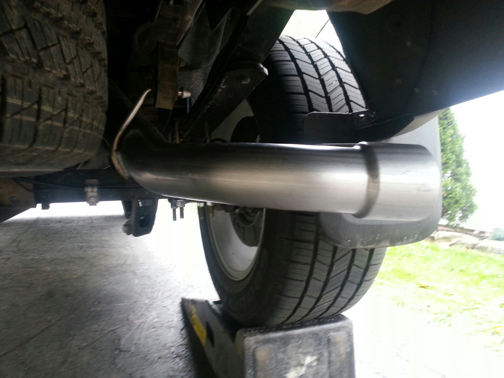

Just installed the aFe catback on my truck.. the install was very simple and the quality is great! Only thing I don't like is the "diesel" exhaust tip that comes with the system. The catback is 3" stainless and then where the tip clamps on it buldges to 3.5" and the tip outlet is 4.5" (as seen in pics). Why are these companies making these so big? Looks like it belongs on a honda. I removed the tip before I even tightened down the clamp and will be selling it ASAP. Looking for a little less dramatic tip .. otherwise the system is great and exactly the sound I was looking for without spending 2.5x as much...
I love the way the exhaust tip looks. Its fitting with how exhaust systems look these days. At least its the single side, not the dual straight out the rear like the old days! What do you think of the sound now that it has broken in a bit? I LOVE mine! I've had Borla, Flowmaster, Corsa, Bassani, Magnaflow and Stainless Works catbacks on many vehicles in the past and this for sure is a contender!
Haha... yeah I remember back in the 70's & 80's when "duals out the back" were the latest craze! Funny thing is, a friend of mine just had his F-150 done that way! (I think it's age-related :lol: )... (Although I'm in my 60's and I'm not a fan of that look on a TRUCK! )
