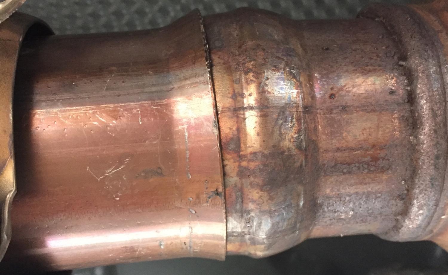

Yup now I have an exhaust leak on that spot I've been referring to where to stock clamp is used. Such a bad design, or I got a defective pipe from Gibson.

Yeah that's weird mine went to get together fine. Not a lot of room to work with but it tightened up pretty good. Are you going to take it to an exhaust shop? Should be an easy fix.
This is what it looks like. It won't go on any further. Took the entire exhaust off today and re did everything. Still has a slight leak. It just won't set up nice to the stock pipe. post-147823-0-62944400-1456692665_thumb.jpeg
I don't have the Gibson system but can you get that pipe seated, the clamp on, and then try to reattach the hangers? I used a Dynomax pipe and mine was difficult to get on because it seemed just a touch too long. Yours seems almost 3/16" short based on your picture.

We have tried everything. I agree, it's like it's just too short. I took the hanger off but t was hard to do anything with it like that cause it's in the way and pushing on the pipe. This picture is with hanger attached and pushing the pipe toward to stock pipe on the truck. That's as far as it will go. It looks too short to me.
I had that same problem with a Gibson on my 13 Silverado, could not get it to stop leaking from that same spot. I guess it must be from the factory, I though I just got a bad pipe too
Did you ever get anything to fix it or did Gibson do anything about it?
I cut that section out and replaced it with the factory flex pipe. I never bothered contacting Gibson
Not a bad idea. Did you just get the flex pipe part welded to the Gibson pipe?
