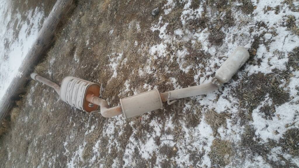

So went yesterday to am exhaust shop and they wanted $200 for the install of my catback.... No thanks... Its in the high teens for temperature here so i didnt feel like laying out in the cold.
Bought a 12pk and did it myself....
Hardest part is getting the stock system out but lifting the truck on the passenger side a bit and dropping the spare go it out.
Volant was a piece of cake to install.... Hardest thing about the install was the head on the hangers is larger then the stock so you gotta lube er up a little before you put it in haha ;)
Took me about an hour and a half with the beer run and all.

SWEET!....you got it done! Pretty damn nice system, eh?? I love my Volant!
Sounds very tame and not as loud as i was expecting. Only drove it for like 5min this morning because i was slightly inebriated lastnight.
Going to brake it in real good when i go home we are talkin about 1800miles straight pulling a trailer
Headers are really going to make it roar i cant wait!!!!!
Put the truck in 1st and nailed it from 30ish and it felt to want to brake loose and thats because im rollin 33s and 3.08s
