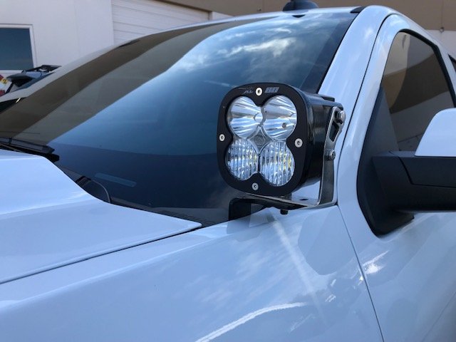

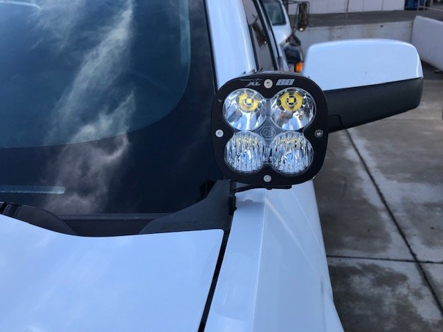

I extended the wiring to the switch to have it reach. Relay is mounted on the fender wall over by the master cylinder and then the wiring is extended right at about the A post, really not much of a big deal. I had to use the 90 degree female blade connectors on the switch anyways so it worked out well.
Now that i think about it, i prob have enough to go without extra. I ended up wiring so the cord from the bar was on the same side as the battery, from the battery i ran across the back of the engine bay over to the driver side n thru the door.
If i just go straight from battery thru passenger door up the pillar that should be plenty.
I got time to play around with it i guess nothing is completely tied down. I zip tied it enough that it doesnt move around

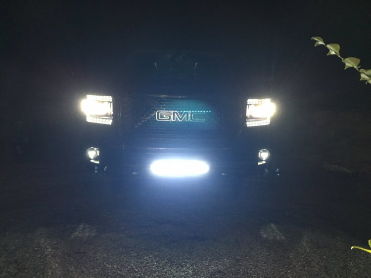

looking good. Any photo of the front with your Z71 grill . How much light got block by cross bars ?
Give me a cpl hours and ill take one. I took one on my break thought it was straight on but lookin at it i was off.
With the bar being straight, in the center it appears to be above one of horizontal bars but i think its from the grille being curved. Once out of the center they shine right thru.
