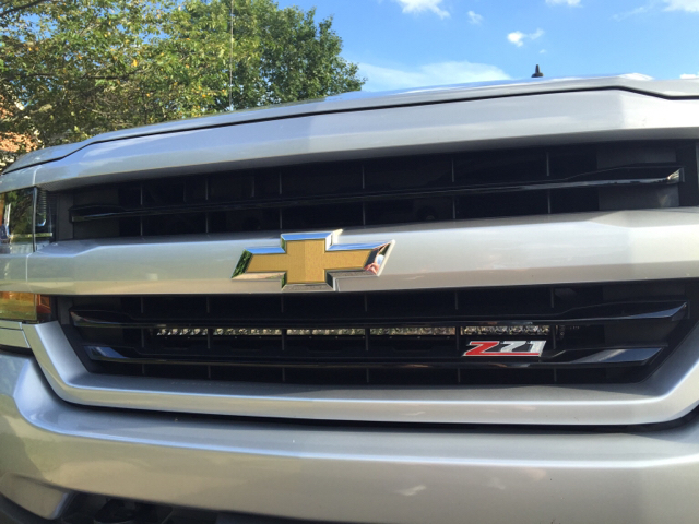

Rigid SR30
^^looks like you're going into the batcave!!!
definitely a cool mod and one that is on my 'to-do' list ... the mod being the LED bar... not the batcave... mind you, having a batcave would be pretty sweet too
