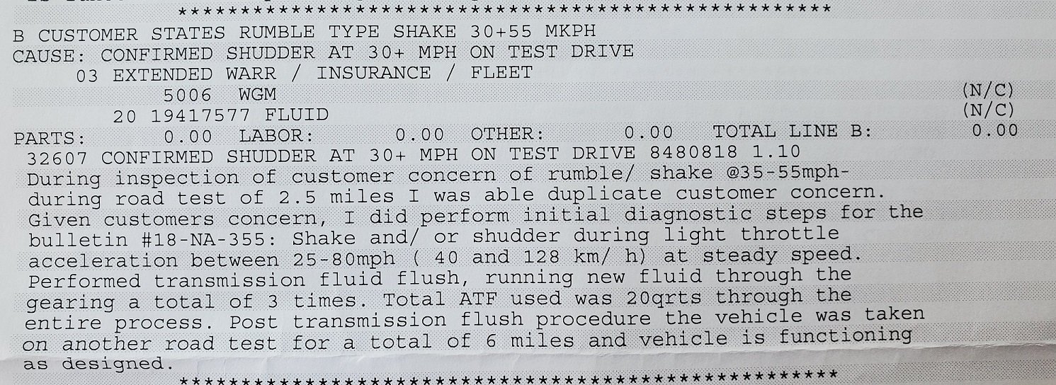

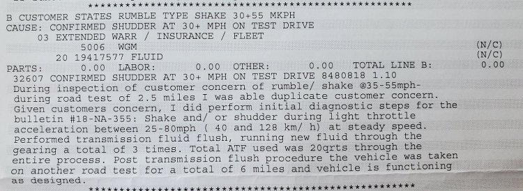

On 4/10/2020 at 4:04 PM, ftwhite said:
Transmission Fluid Flush  - bulletin #18-NA-355
That is what I thought they did on the TSB, but everyone on here is saying that you can not do a flush on the 8 speed.
Did they let you know what they were going to do before hand? How is it working now?
Fixed the vibration I had. So far so good, but still waiting to see. It did great picking up mulch today though.

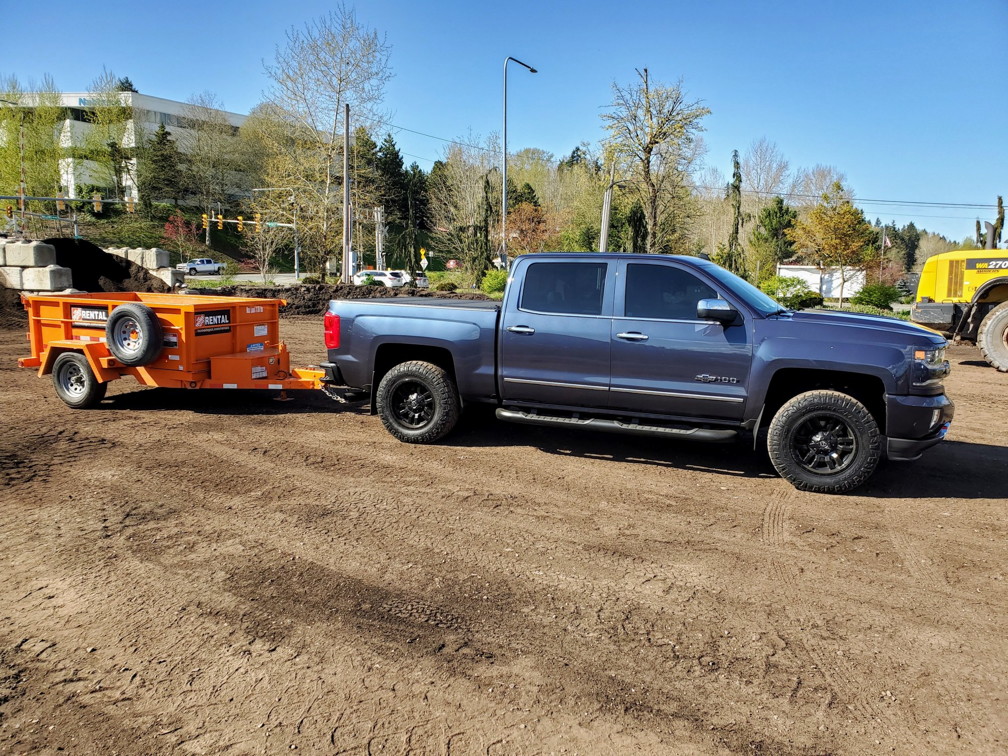

I love this look, big tires on stock height, seems not lifted or maybe a bit leveled ? What is your tire size ? Have a nice day ! Robin
Why can't you do a flush on the 8-speed?
Thanks. Leveled with Fox coil overs. Replaced w/ 2.25 inch blocks in the back. 275/70 r18 Nitto Ridge Grappler (33.2 x 10.8). Top of the fenders are 39.5-40 in the rear, and 38-39 in the front. Its twisted though...in the front the right side is taller, in the back the left side is taller. Only by ~1/2 in. Never bothered to fix it.
