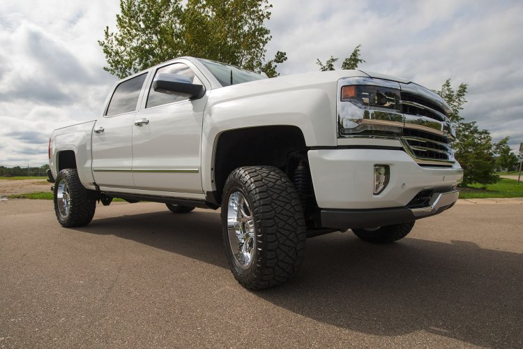

Nice looking rig.  Love the wheel & tire combo.  Could you please give us some details on the specs.. lift, level,  tire size, wheel brand ?  Thanks and very nice outcome. ?
Nice looking rig.  Love the wheel & tire combo.  Could you please give us some details on the specs.. lift, level,  tire size, wheel brand ?  Thanks and very nice outcome. [emoji106]
Thanks, it’s a 4 1/2” CST bracket lift with CST coil overs, rear is stock block and Deaver J1 mini pack leafs, CST street series shocks. Wheels are 20x10 -19 Hostile Rages with Nitto Ridge grapplers in 305/55/20.
The Ridge Grapplers are the lighter version, 52 lbs. compared to the E versions 62 lbs. I wanted to keep my 6.2 performance. The ride is very nice and an improvement over stock.546c7a30e91cd00e41c8d32a7f95e131.jpg
