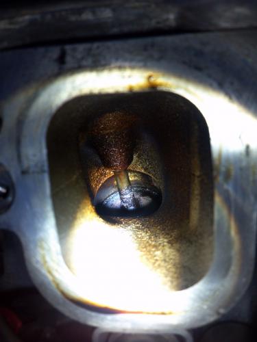

I'm not denying carbon build up. I'm saying carbon build up isnt that big a deal. It robs power for sure but like I said its part of the package with all these direct injection motors. They have had this issue for 7-8 years. Trust me, I know. Ive had my Audi "carbon cleaned" 3 times in 4 years and it costs about 800$ each time. I consider it cost of ownership. The only way to do it is open the motor up and scrub the valves manually or with a walnut blaster. Catch can does nothing, cleaners do nothing, its been proven over and over and over. Its just now that the domestic companies are starting to use this technology more frequently these debates are starting to come back up again.
My Audi at its first carbon cleaning, just for reference:
