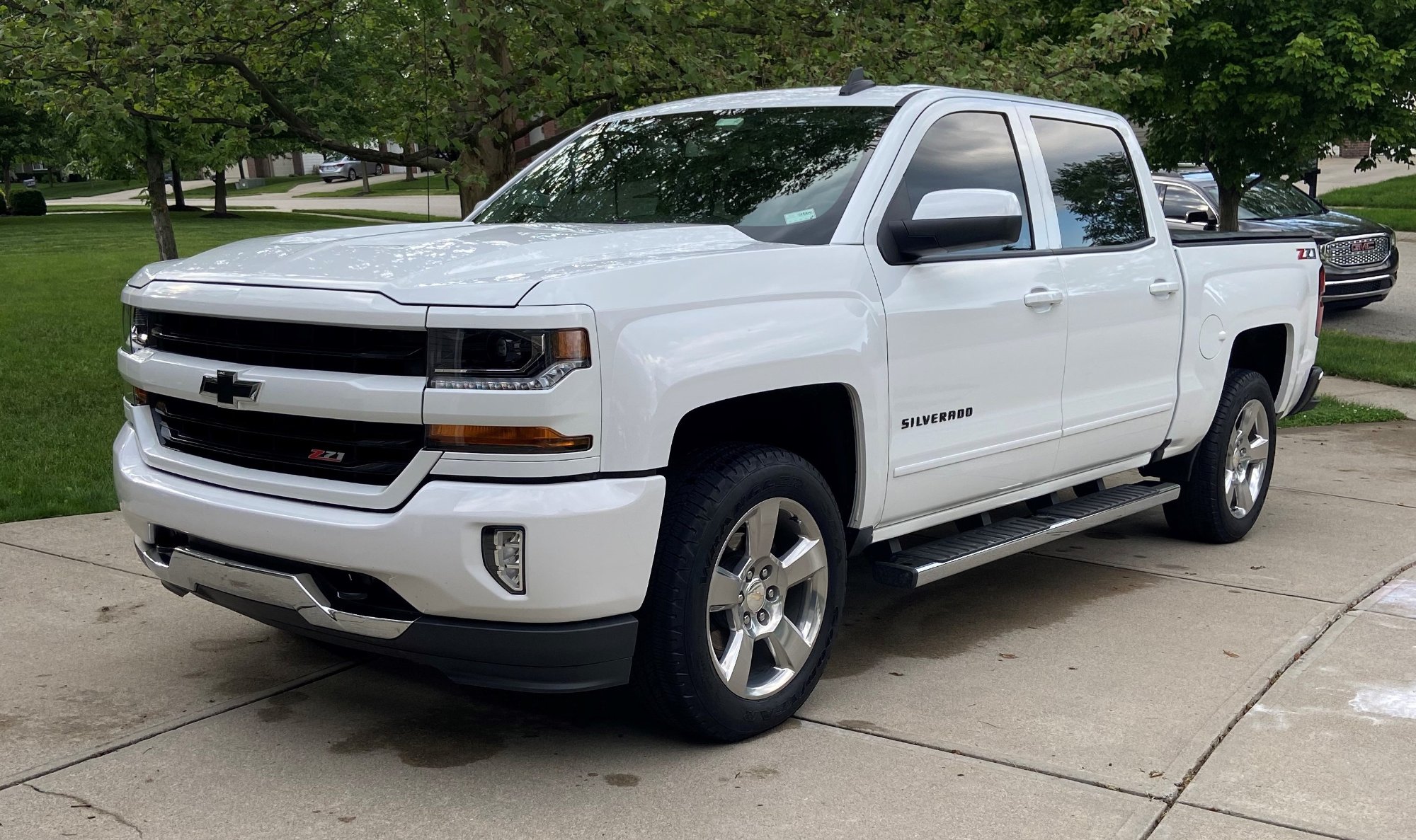

10 hours ago, Daws18LTZ said:
Got my 2.5” Rough Country leveling kit installed, accompanied by 2” wheel spacers all around and Nexen Roadian MTX 33” tires wrapped on stock rims. Needed a bit of trimming in the front but overall nothing drastic.
Great job! Nice looking truck! :)
