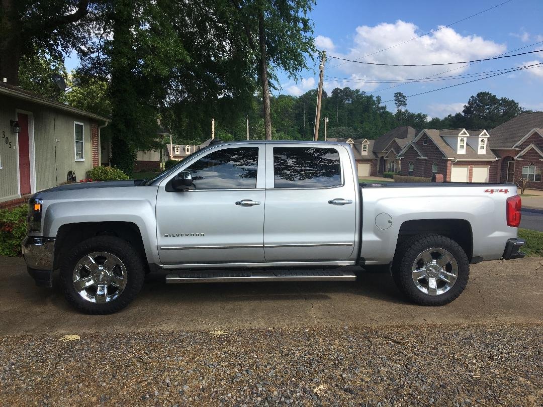

2018 Chevrolet Silverado LTZ with 295/55/20 Nitto Ridge Grapplers and a 2 inch rough country leveling kit. I know a lot of people like aftermarket wheels but i love the stock LTZ 20s. Thinking about possibly doing the 2.5 kit on the front and the 1 inch block in the rear.

How have you liked the 2" rough country kit long term? Any issues/complaints? I have same truck color and all and was thinking about the RC 2" leveling kit and Nitto Terra Grapplers but I haven't pulled the trigger yet. Thanks!

I haven't had any problems. I ran a 2 inch level kit on my last truck and never had problems. At times i wish i would have went went the 2.5 inch kit but i am fine with this one. A lot of people think 2 inches should be the max though. What size tires do you plan on running? I thought about 285/60/20 for my next ones. I am fine with a little bit of rub. Put some pictures on here when yours is complete!

I looked heavily into the 2.5" as well but dont want the extra stress on the suspension components etc. I also like the little bit of rake the 2" has. Ive been looking at 275/65/20 with the stock rims as I really like the looks of them as well. Im also purchasing bilstein 5100 shocks and struts to replace the stock ones. I will definitely post pics after I get everything installed, I appreciate the feedback!

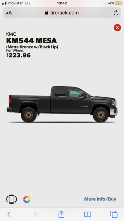

It’s potato quality but here’s an example -
https://www.methodracewheels.com/pages/chevy-wheels
I’d go with bronze and the 285/75/17 coopers, I love mine. Check out my build thread for pics

I found a picture from SDHQ’s website. Saw you have their skid plates. Pretty badass! Love the Bronze wheel look too. I’ll post pictures of mine once I finish installing everything.
How many miles do you have on your Coopers? And how have they been off-road for you?
