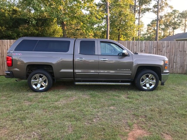

On 9/11/2020 at 4:41 PM, mgnic said:
2014 LTZ with stock wheels.  The after pic is with MotoFab 2" level kit,  Bilstein 5100 all the way around and Michelin Defenders 275/60 20 tires added.    I really like how it turned out.
Any rubbing issues? I am considering the moto fab 3 inch front spacer and 2 inch rear block. I want to put 33's on my truck as well.
