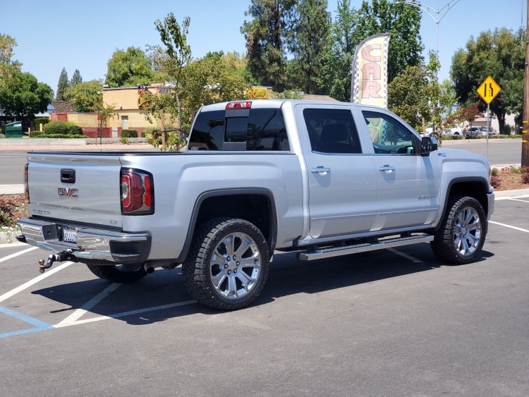

I’ve been running a 3” level up front with forged Rough Country upper control arms for almost 20000 miles now and have had 0 issues. I’m running a 315/70/17 BFG KO2. (Not a big rim guy) I did have to do some trimming to keep it from rubbing. I would think a 305 would fit fine as long as you don’t go crazy with negative offset. My rear is stock with Bilstein 5100s. My front is about 0.5 higher then the rear but very hard to notice most of the time. I don’t tow anything either.
3” is the max I would go. Anything beyond that is probably asking for problems. I would definitely replace your UCAs. The stock ones will be struggling. I also have some Kryptonite outer tie rods sitting in the garage. Just haven’t had a chance to put them on yet.
f90108261fe1d87e88c8510fa5accc40.plist
Thanks for the response, and especially the pics!  Your truck is actually very similar to where I'm hoping to take my truck (even same color), and it's been hard to find pictures of the look I'm going for (including black bowtie and grill mesh), so you posting them has really helped me see what it might look like when it's done.
