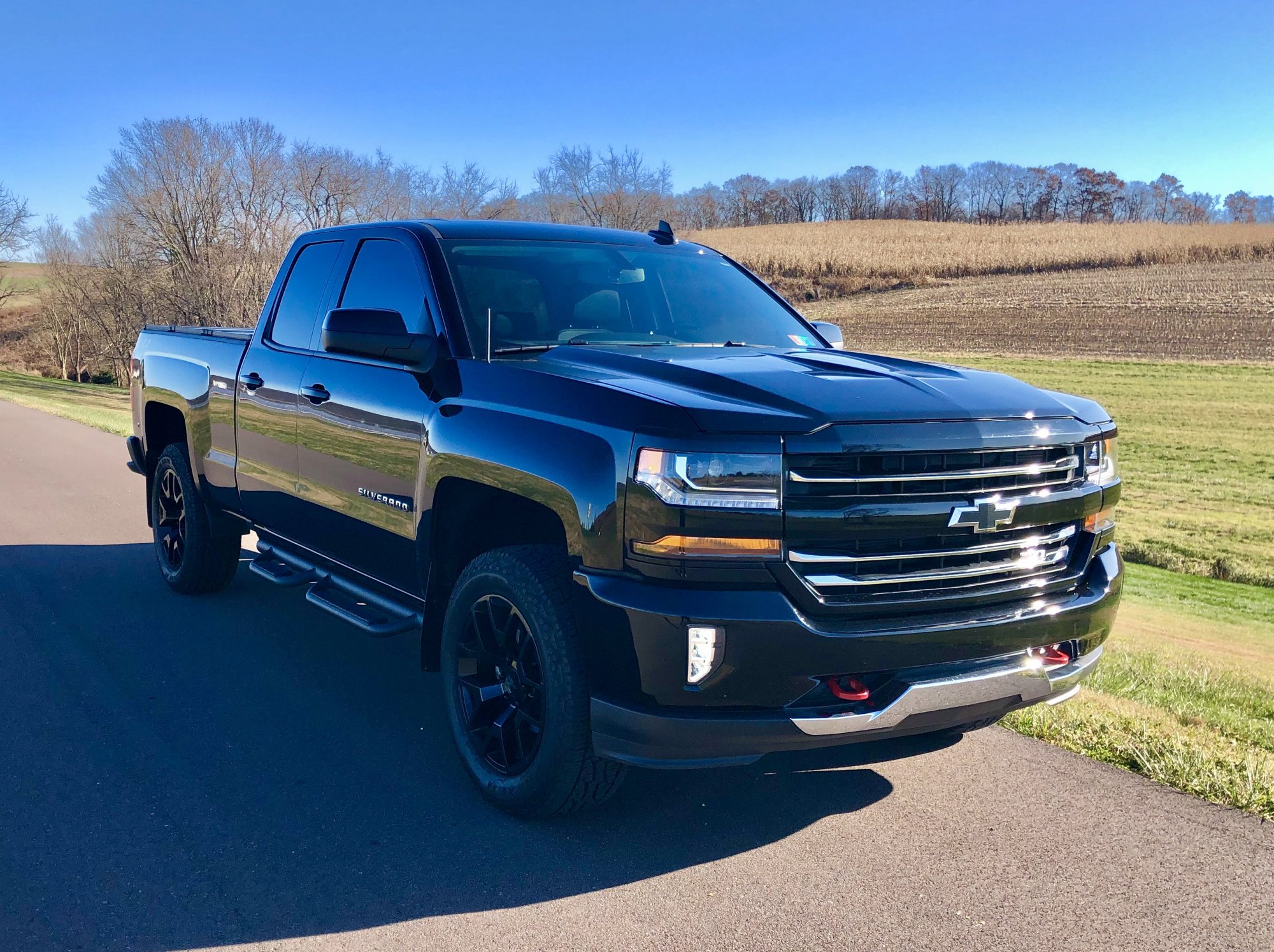

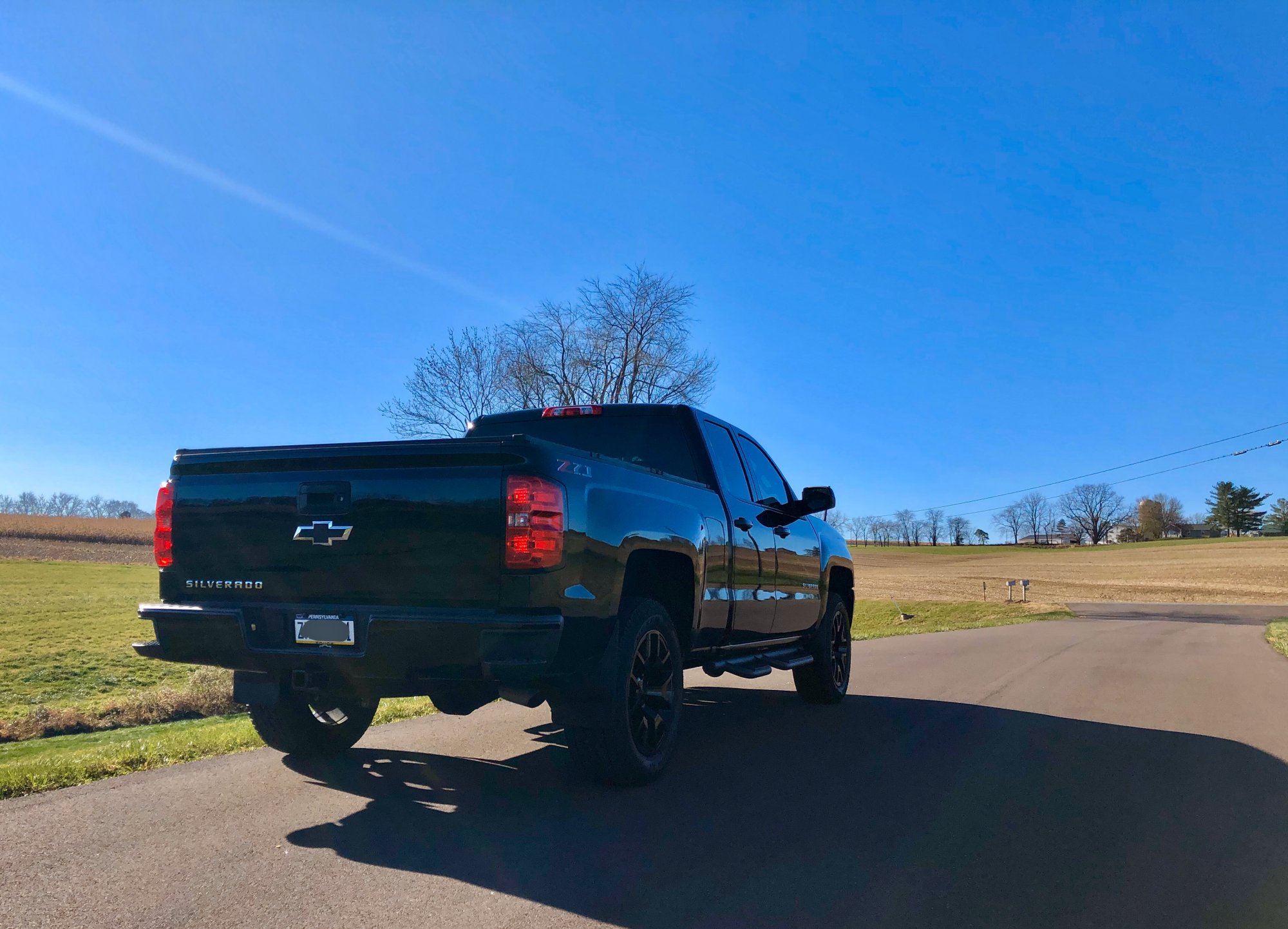

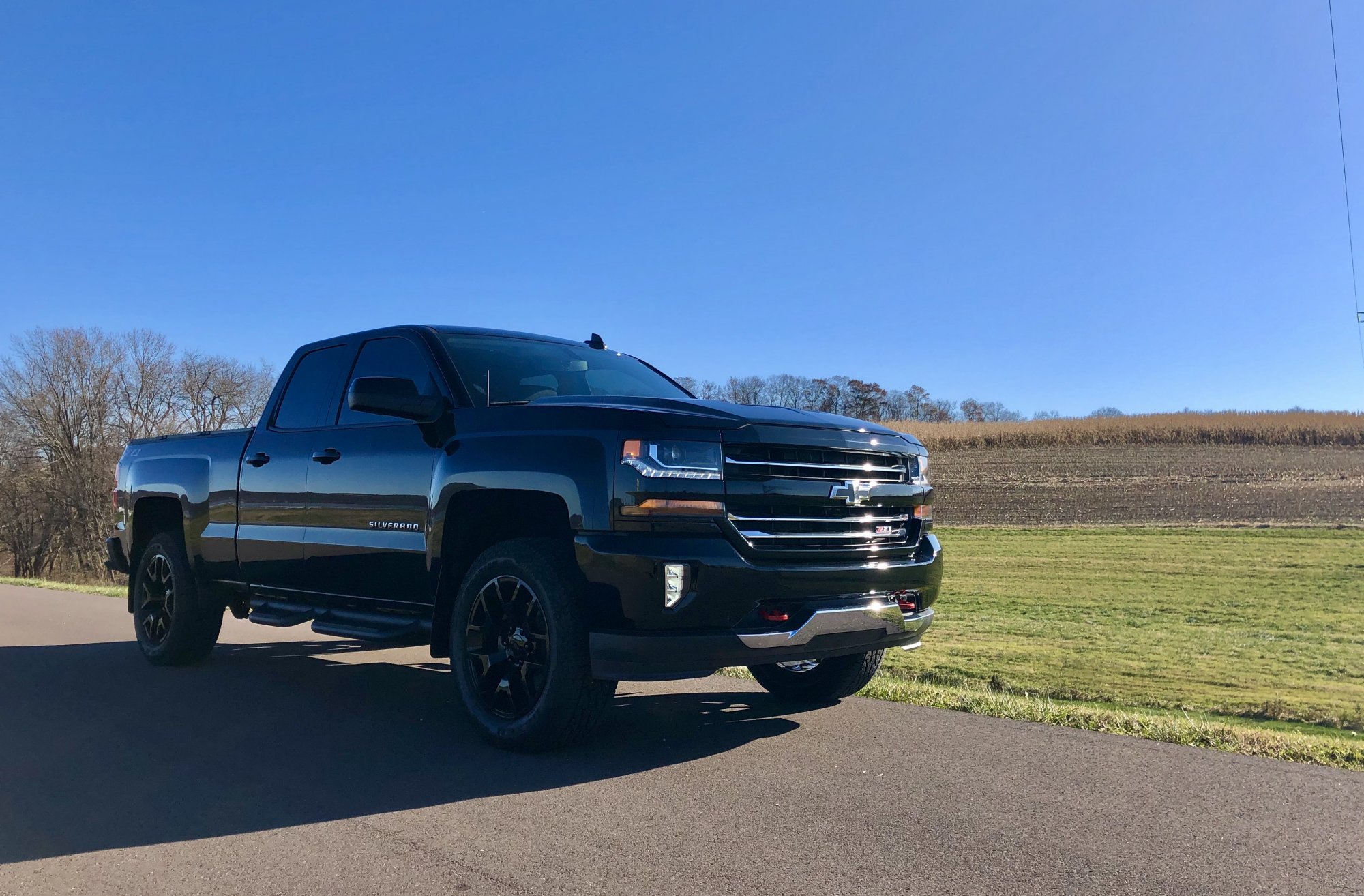

Well had to do it. Stock wheels wouldnt stop rubbing at full cock to the right with new Freedom UCA's. Bought some KX offroad (makers of XD) 18x9 with -12 offset wrapped in 265/65-r18 Falken Wildpeak AT3. 33x12.5r18 dont fit. I get the rub on rear fender well and im not cutting or banging my new truck. Ill wear these out then raise my truck another inch and try for 33's next time. Gonna install some lighting next.aaed7a2bcb41944d59cb532e98dd271b.jpg6b6caf92f3e7f53edb905f2b845052af.jpg47db913f3200cf5dca3aff0fdf47d23b.jpg

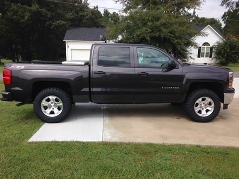

Anyone on here ever tried 285/70/18 tires with a 2" rough country level on a 2014 chevy Silverado? My 275/70/18 toyo open country m/t's have 55k miles on them and its time for a new set. I'm tempted to try the 285/70/18 in nitto ridge grappler. Anyone have this set up? If so, any rub and how much? Attached is a pic of my truck with the 275/70/18 toyo open country m/t (33.6 x 11) with no rub.
