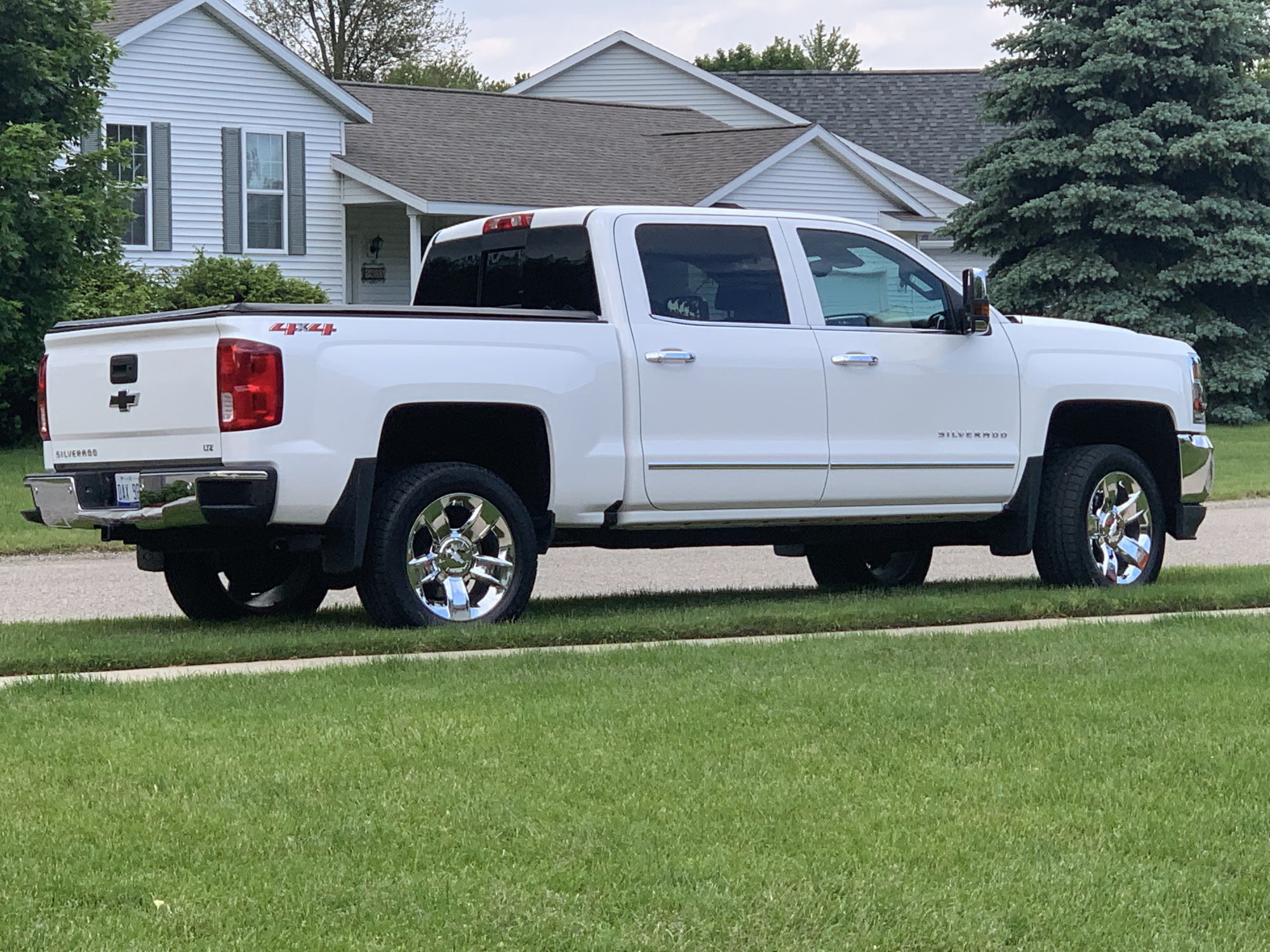

Thats what i have, along with readylift ucas. Have had no issuesbbb60b3b8e4666ce2886e03eb79fc444.jpg08595da76a64308f4eefe2c949680161.jpg
Sent from my SM-G973W using Tapatalk
I didn’t get UCAs, I guess I am hoping that I’m ok with the stock stamped ones. Truck looks nice!

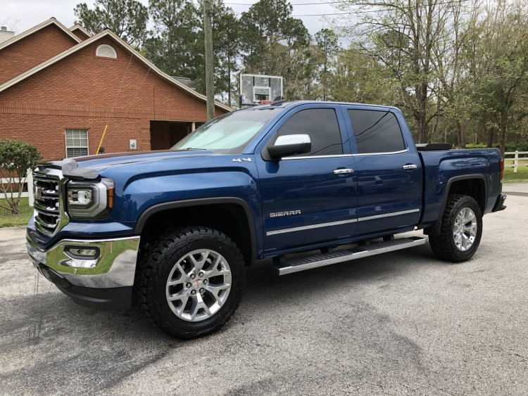

I have basically the same setup that you intend to install on stock 20” with 285x60R20 Toto Open Country RTs and had to add RC 1/4” wheel spacers to stop the rubbing on UCAs and sway bar.
Are they from Kansas?  :P
I'm still learing the offsets and trying to figure tires and rims. Assuming stock rims and guessing you have +27 offset, that tire moved the inner sidewall exactly .24 " closer to suspension and frame. I might be wrong and others with more experience please chime in, but... If you moved to a +20mm offset, I don't think you would need the spacer. A +20 offset would move the outer sidewall .08 away from suspension with that tire. You did increase the total diameter of the tire though significantly and that could present issues. Total tire diameter would increase from 100.2 up to 105.1  Truck looks nice with tires and level.
What bug deflector do you have?  That is the style I am looking for and have the same color truck.
