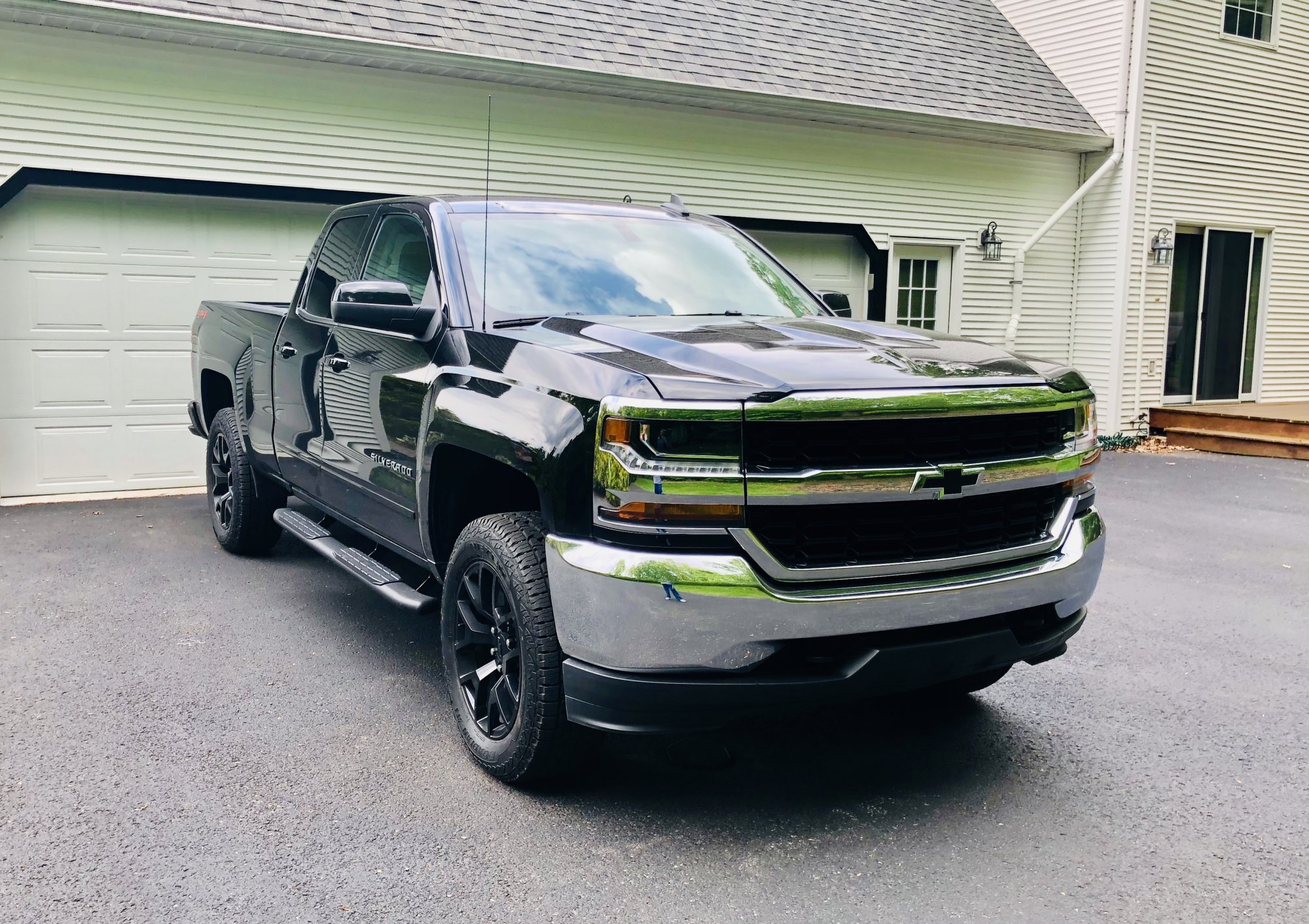

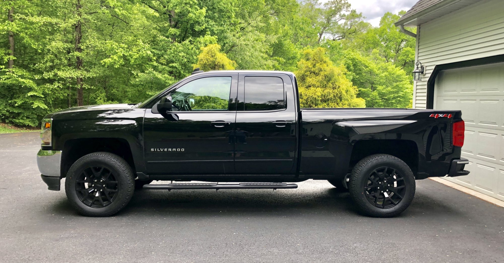

I have 2.5 front 1 rear. 305/65r18 tires. My fenders are around 40.5 front and 41.5 rear
