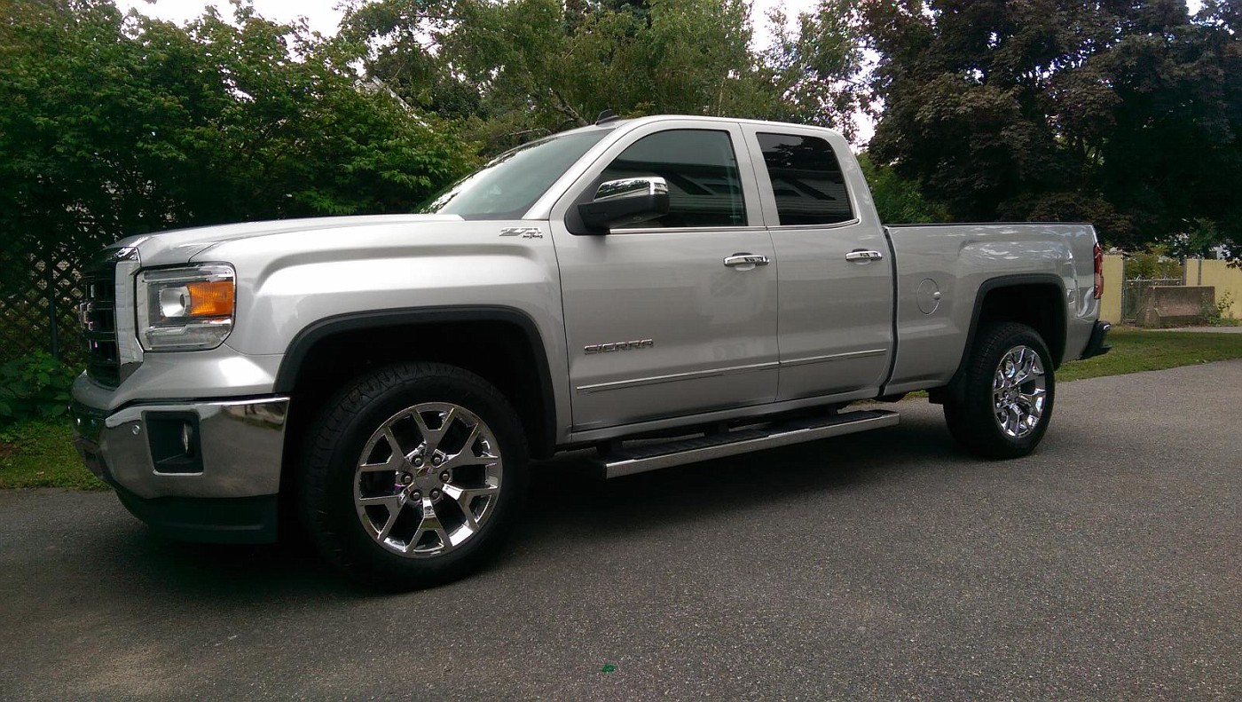

Here is mine (GMC) and my buddies (Chevy). Both have 2.5 Rough Country and 1.5 Zone Body lift. His has 18s with 33"BFG. I just bought some 275 60 20 Terra Grapplers. Get them mounted next week on my factory rims.
2.5" level, factory rear block and 295-60-20 toyo AT II
Truck looks badass. exact tire I'm stuck on ... Any rub issues ?
No rubbing at all. The wheels are factory
Disregard just read the answer lol

Is this one of those new fancy photo filters?!? or just trying to oversize the photos... With the level and body lift, do you have or can get pictures showing clearance at closest impact points? Really want to run this setup with larger tires. Close to 35's. Thanks.
No filters applied other than just some color enhanced. I have a clearance pic of my buddies Chevy. Here you go. Wheel at full lock.
