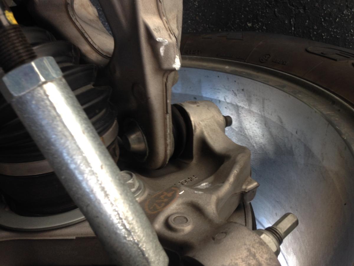

Installed a readylift leveling kit about 2 weeks ago. Went to re-check all bolts and noticed a couple things that I wanted to check with everyone here. 2014 Crew Cab LTZ Z71 4wd. Installed 2.25" Readylift up front and their +1 in the rear. Noticed that the "washer" looking pieces inboard of the bolts on the bottom of the strut seem to be pushing out at the top. Anyone else seeing this on a stock or leveled truck?
Also, there seems to be a contact point between the spindle and bottom control arm. Think its just a steering stop but wanted to double check that as well.
Spoke with a ready lift tech and he said steering stop seemed normal but the bottom strut issue might be a problem. One of the other techs he had look at the pictures said it was completely normal.
Any input is appreciated.
My TGC kit included new nuts, bolts and washers. IDK if I'd feel comfortable with using the stock clamp nut with a spacer or even running stock clamp nut with no spacer for that matter. Seems like it could be an easy point of failure.
I would grab a set of grade 8 or 10 (can't remember which they were) nuts, bolts and washers and replace all the stock stuff just for piece of mind.
The hardware that came in my kit was from Fastenal
