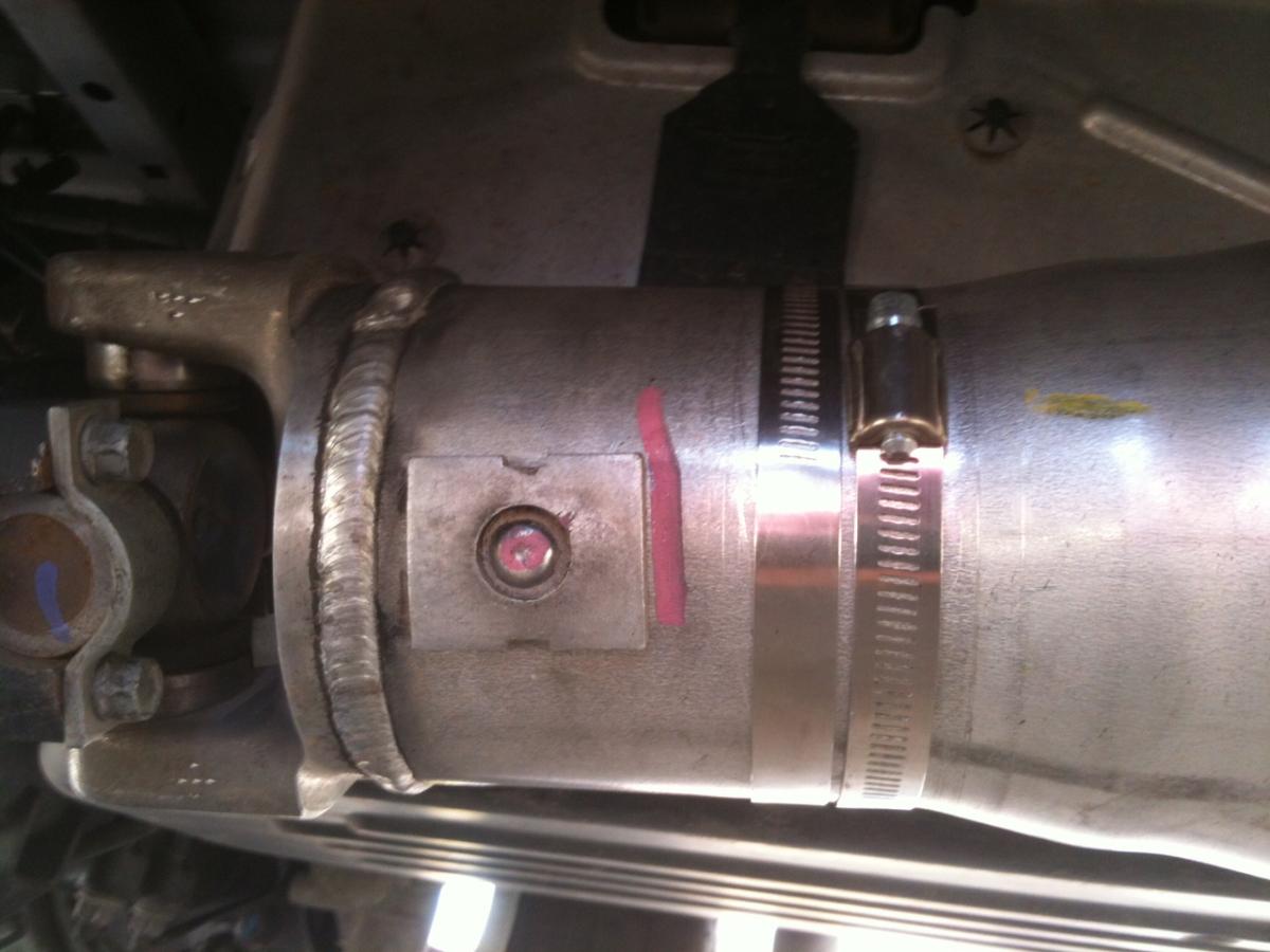

Just now had time to look under the truck.
The GM Engineer's way of balancing the drive shaft is the DIY method of using two clamps.
Thoughts anyone?
That's quite acceptable as a temporary measure, however drive shafts are balanced by spot welding a weight onto the shaft. Be it as it may, if there are no more vibration probelms, I would leave it alone.
