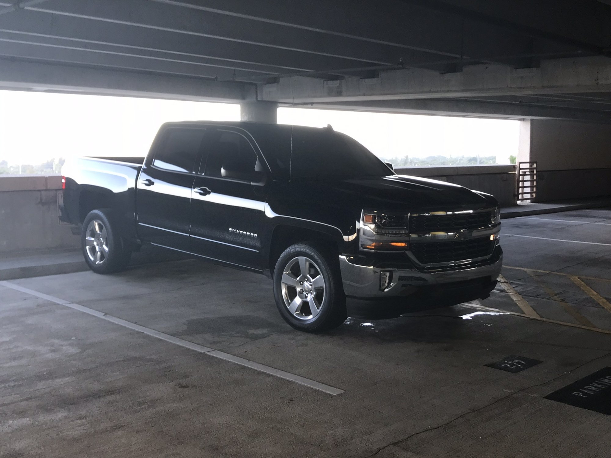

Trying to figure out if my '16 Crew Cab that I just purchased 3 weeks ago has this shake.
When driving above 65, I feel a slight vibration through my steering wheel. If I let go of the wheel, I cannot see it moving. I also don't hear anything inside the cabin rattling such as my sunglasses in the holder. None of this vibration feels like it's coming from the rear. Like I said, I can really only feel it through the steering wheel.

my guess is either your tires need balancing or you need a front end alignment.  Being your truck is a 2016 I'm assuming you have some miles on it?  If so, inspect your front tires for any irregular wear or scuffing, especially on the inner and outer edges.  If there is any indication of this I would have the tires rotated and balanced as a start.  If problem still exists I would have the front end aligned.  However, if your tires are worn and close to needing replacement I would do this first then have both balancing and alignment done.  Btw, none requested suggestion;. I run Michelin tires, in my opinion can't go wrong with them.  Good luck ?!

Okay cool. I'll try going that route first. Thank you.
